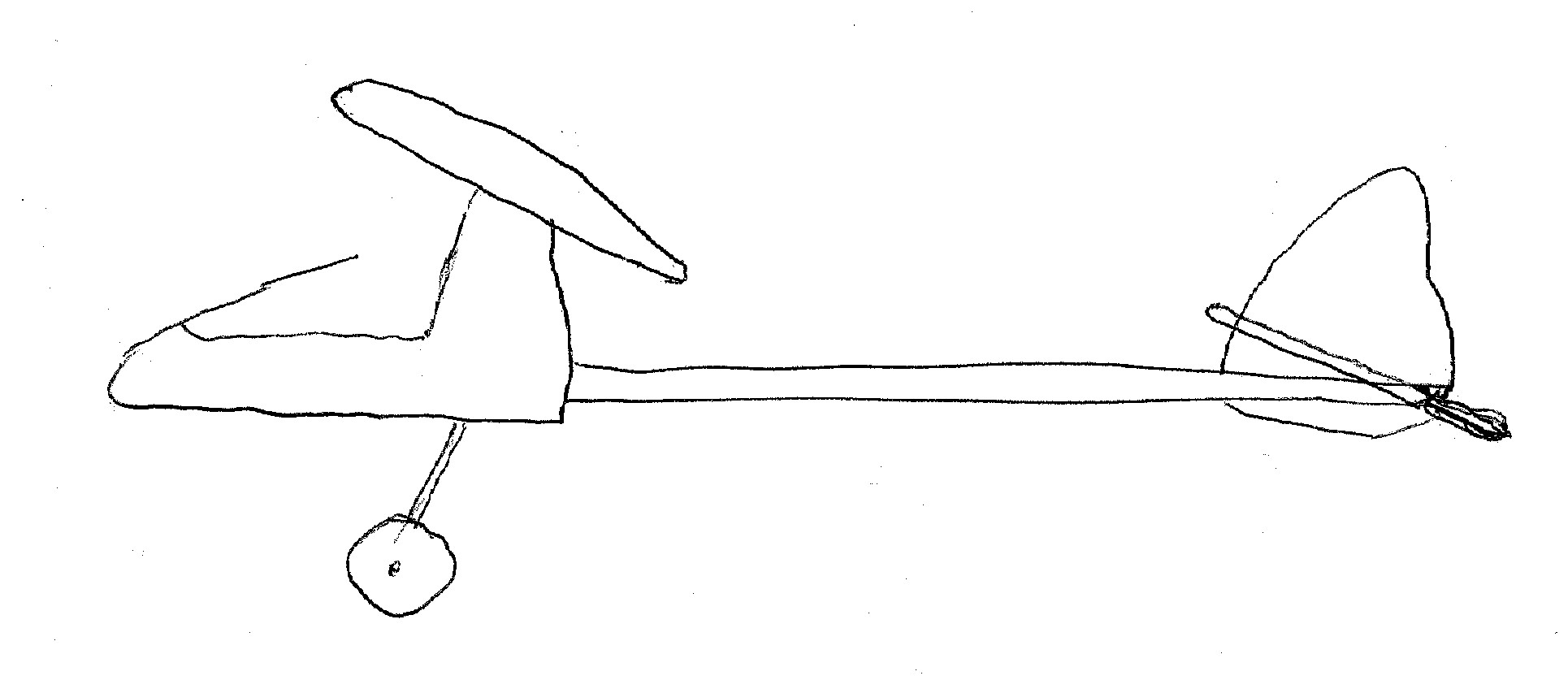

neilsenrm(at)gmail.com
PostPosted: Tue Aug 28, 2018 7:26 am    Post subject: First short XC Flight and Slow Cruise Speed Reply with quote
I know Bill has verified the W&B is correct and the wing angle is correct but based on the horizontal stabilizer angle the wing just has to be set with too high of angle of attack. Bill check two things. Check the angle of the underside of the wing and the angle of the horizontal stabilizer from level. I'm betting they are real close to being the same. The wing will have a bit more.
Then raise the tail and set it on something where the horizontal stabilizer is level. The stand back and look at the airplane. I think you will see the tail is very high and the nose is very low. The ground will represent the direction of airflow the plane will see in flight. Wind hitting the additional surface of the fuselage due to this flight attitude maybe enough additional drag to cause your speed reduction.
See the attached. I have exaggerated the drawing to better show what I think Bill's plane maybe like. Again the drawing shows much more exaggerated angle of the wing and horizontal stabilizer than Bill's plane.
I think the leading edge of the wing needs to be lowered. Get two of the Kolb (Steven Green) adjustable universal joint fittings and install them on both wings raising the trailing edge as far as they go or maybe just a bit at a time and go fly. Be prepared for the need of up elevator. Does your cruise speed increase any? The adjustable universal joint fittings allow you to change the angle of attack of the wing for testing purposes and make it easy to go back to where it was. I think you will need to reduce the angle of attack quite a bit on the wing to get the plane flying level. Remember to lower the horizontal stabilizer.
As always worth what you paid for it.
Rick Neilsen
Redrive VW Powered MKIIIC

My aircraft does indeed look like Rick's sketch.
But I HAVE NOT changed the wing-to-fuselage angle (incidence) at all. If the wing looks like it is sitting on the fuselage at a ridiculous angle then it was welded that way in Kentucky. The main spar pin hole (which sets the incidence angle) on my aircraft is within 1/32" of exactly where Kolb says it should be.
Rick's sketch shows the tail pretty much parallel to the bottom of the wing. No Kolb Firestar is this way. The stock plans built Firestar has the stabilizer at a significant angle to the wing, meaning WHATEVER angle the fuselage and wing is flying through the air - the tail is "digging" downward quite a bit.
Rick's sketch looks like there is no difference between the wing and tail angles... this would be unsafe on almost all aircraft, and require the pilot to be pulling back on the stick with all his strength to keep from diving into the ground.
On my aircraft I reduced the stabilizer/tail angle (because I was tired of pushing forward on the stick) but DID NOT ELIMINATE this angle.I have a solid 4 degrees of tail down-angle. Whatever angle that the wing and fuselage are flying through the air, my stabilizer is "digging" downward 4 degrees lower than that.
bit more.
than Bill's plane.
stabilizer.
it.
Rick NeilsenRedrive VW Powered
