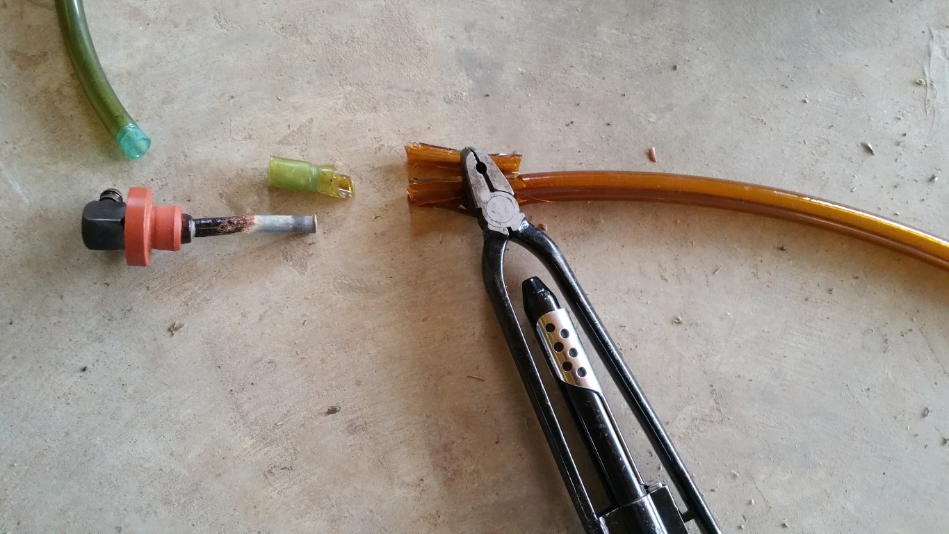

Even high grade fuel line will degrade, if it isn't rated for in-tank
use. The liner is fuel proof, but the jacket isn't. I discovered that
about 4 years ago, less than a year after restoring a Twinstar. I
initially set up a 'flop tube' using the common grommet style fuel
fitting with a short metal tube brazed into the inside end, and the
common blue urethane hose connecting the fitting to a weighted screened
pickup. Less than a year after assembling it, the blue urethane tubing
rotted away at the tank fitting (image attached). When I looked for
regular fuel hose, I discovered that 'in-tank' (submersible) rated hose
sold for way over a dollar *per inch*.
Here's an example from Summit (lots of other examples available):
https://www.summitracing.com/parts/hly-26-161
That's when I converted the tank to bottom exit....
Charlie
