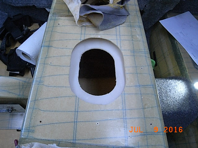

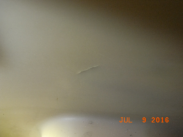

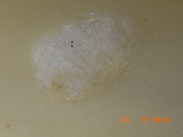

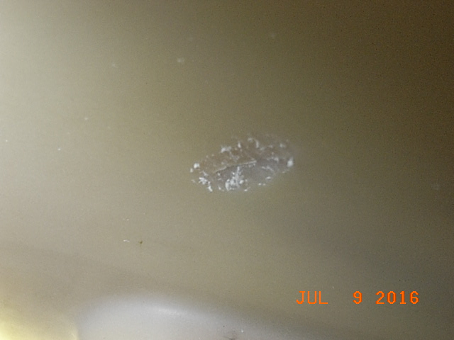

My tank developed a split but I didn’t want to go through the hassle of fitting a new tank, so I looked at alternative ways of overcoming the problem. In the end I repaired the tank in situ, the repair has held up for the last two years so I’m glad I didn’t rip out the original tank.
Watch this video to understand the process to repair the tank https://www.youtube.com/watch?v=Lqu3NVqFNCU
For access I cut a hole between the headrests in the cockpit module, then cut a smaller hole in the top of the fuel tank below (having drained it first), this allowed me to see inside the tank & I could see the crack for the first time. I figured I had nothing to lose doing this because it would be an easy repair if I ended up cutting off the top of the headrests to remove the tank before fitting a new one as per Bud’s instructions.
There are some pictures (hopefully).
I followed the process in the video above. It was a bit awkward working through the cut-out in the tank top but it was doable. I had to buy a small heat gun for the welding process so bought one of these https://www.youtube.com/watch?v=RFxN65eJWOo The panel I cut out of the top of the tank was used as ‘welding filler’ for the repair.
I developed a repair scheme that was approved by our LAA in the UK. I made up a removable cover for the cut out in the cockpit module between the headrests which was bonded on and made a nut-ring and cover out of aluminium with a gasket to seal the top of the fuel tank.
I now drain and clean the inside of tank every annual inspection to see how the repair is doing and all seems good so far.

The repair after hot-air welding.

The spit ground out with a dremel.

Tank split in the rear face of the tank just above the saddle.
 Filesize:  89.16 KB
 Viewed:  19641 Time(s)

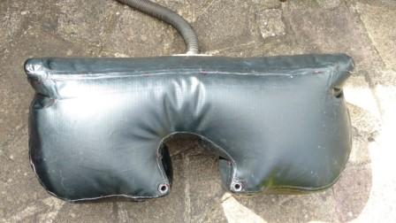

You may be wondering why I cut a hole in the top of a new tank, the reason is that I was going to fit a bladder inside the original tank. This didn't work out because I couldn't make a fuel-tight bladder and getting one manufactured was prohibitively expensive. It remains an option though.
Here is one of the bladders I made. The material is strong, flexible and impervious to fuel. I just couldn't make one without pin holes in the seams. This bladder is fitted inside the tank through the cut-out hole you see in the tank top.

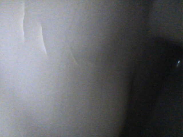

PostPosted: Fri Aug 31, 2018 12:42 am    Post subject: Re: Roland Schmit Europa. Fuel Tank Debacle. Reply with quote
So - unfortunately my tank developed multiple (!) cracks, so that a repair is definitely no option. On the photo you only see one spot on the starboard side.
As already suspected the rigid bonding to the cockpit module at least contributed to that.
Anyhow - thanks again for all opinions, help and sympathy.
