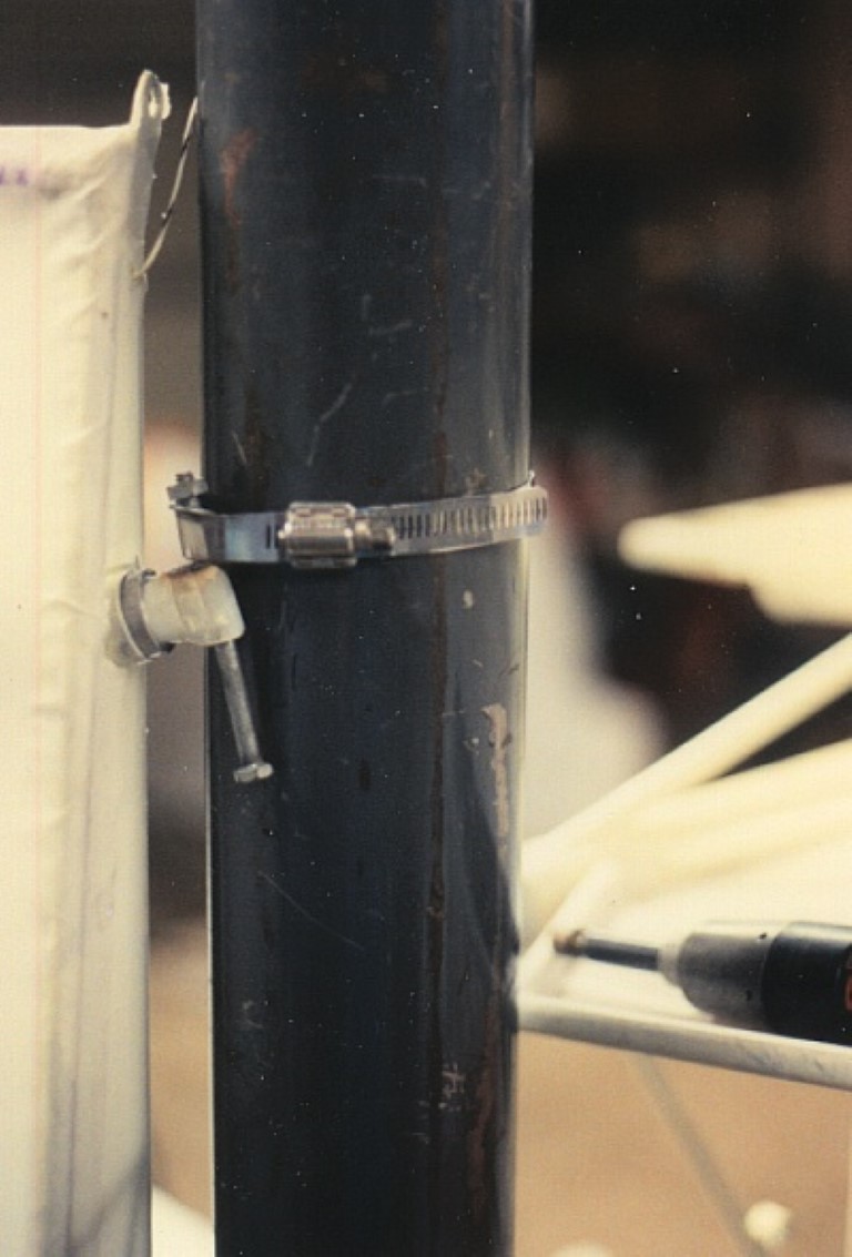

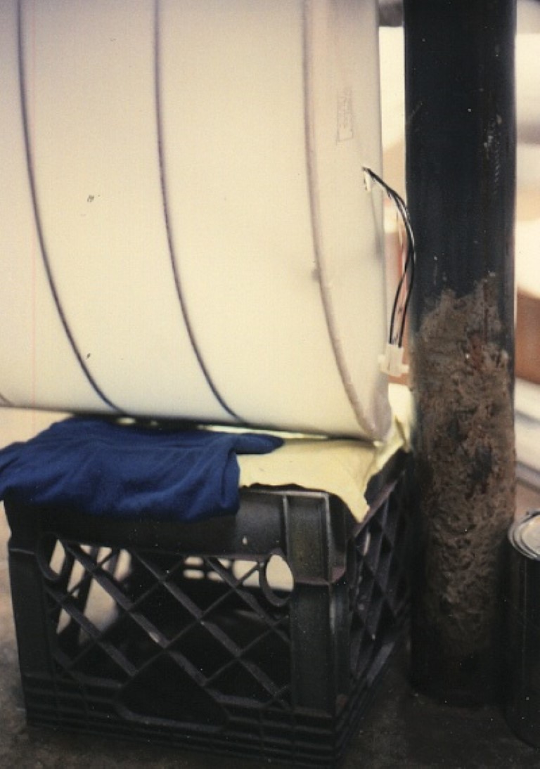

PostPosted: Sat Aug 04, 2018 12:37 pm    Post subject: Re: Firestar/HKS Engine Test Run Reply with quote
Sorry I don't have what you are asking for, but here is the crude way that I did the MKIII: I have a steel support pole in the middle of the garage that supports the upstairs floor, and I put a extra long bolt through the rear spar pivot point, band clamped it to that pole, and then set the leading edge on two milk crates. One crate near the root and one near the tip. Worked OK. Not great, but OK.
Had to put it on sawhorses to do the leading edge top and bottom.
