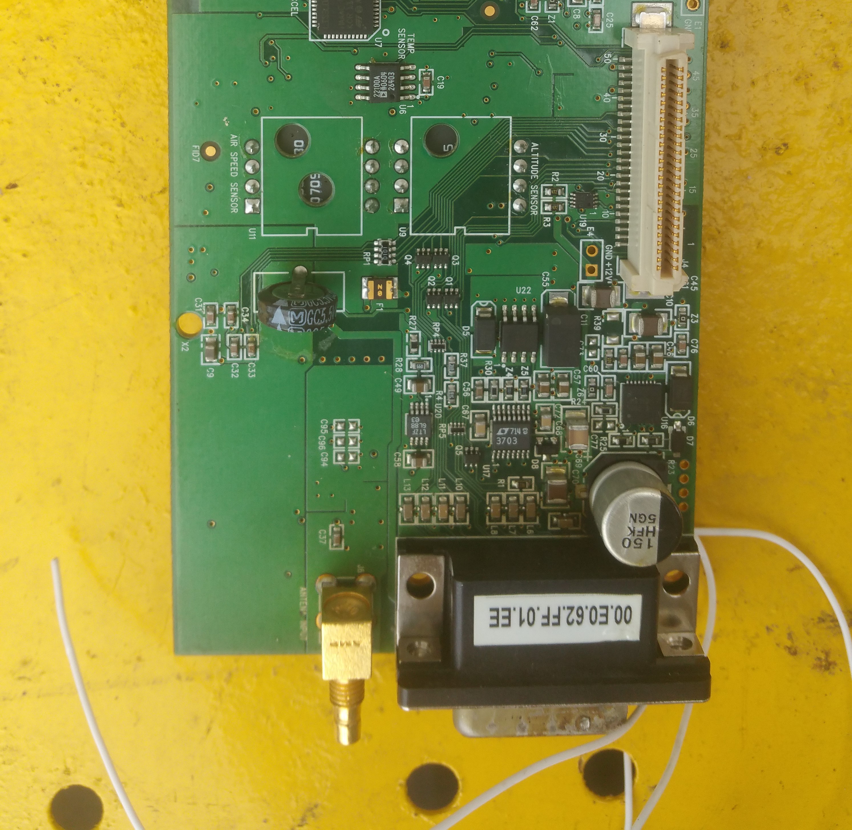

I think the item linked below will work. I do have one question. This item has PCB snaps. The current unit has the holes for the snaps, as does the board, but the snaps are not installed. Besides helping to secure the connector to the board, would those snaps also ground the outer shell of the connector through the snaps? Should I remove them from the below item before installation on my board?

PostPosted: Tue Jun 07, 2022 8:57 pm    Post subject: Need another source or brand of 26 location HD D-Sub Connec Reply with quote
My first two attempts to reply with photo attachments bounced back. So I've put the photos up on PostImage and will link them here.
https://postimg.cc/bZ4RtNVM
https://postimg.cc/pmmZrnCz
I think the item linked below will work. I do have one question. This replacement D-Sub has PCB snaps. The current unit has the holes for the snaps, as does the board, but the snaps are not installed. Besides helping to secure the connector to the board, would those snaps also ground the outer shell of the connector through the snaps? Should I remove them from the below item before installation on my board?
https://www.digikey.com/en/products/detail/conec/164A18189X/2080286
The second photo shows the underside of the board, below the D-Sub. The 3 wires soldered to the board are a kludge repair done by the bozo who damaged the D-Sub.
