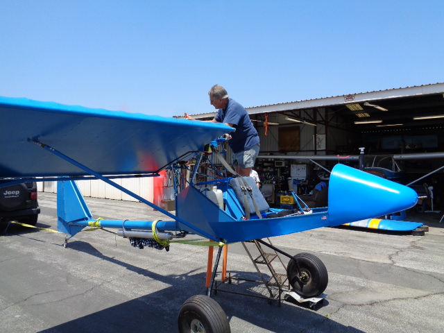

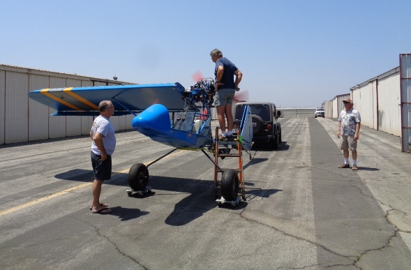

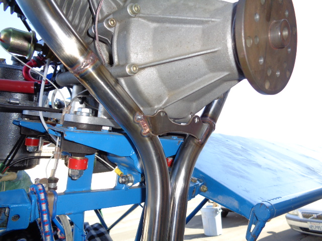

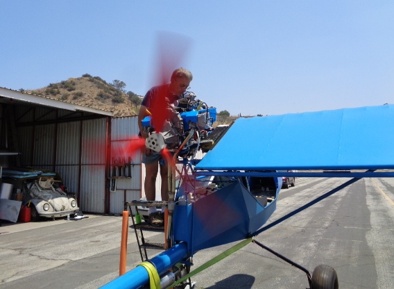

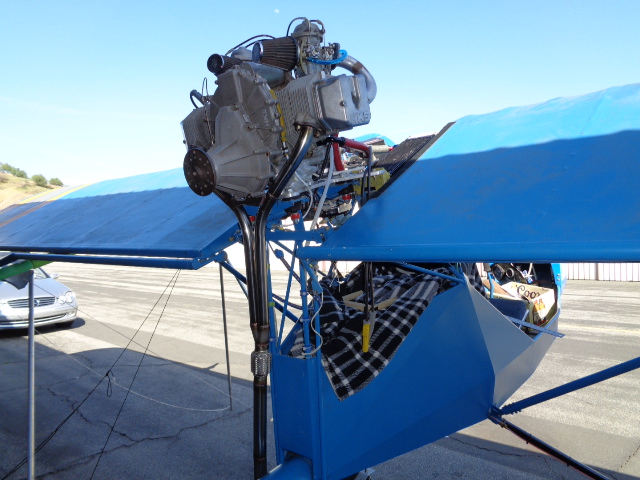

Yesterday we finally were able to test run the HKS engine installation on my Firestar 2. The HKS engine started right up and ran, but it needed carburetor adjustment. I had a friend there who has experience with the HKS engine, and he was kind enough to adjust the carburetors using a dual vacuum gauge.
The one big issue I had was that the engine vibration was far far more than I was ever used to seeing on an aircraft. Part of this is that I'm "an airplane guy" instead of "an ultralight guy", Part of it is that the HKS is an opposed 2 cylinder engine with a very high compression ratio (11 to 1). But part of this is also that it did shake and vibrate a LOT, and I started thinking about how things tend to get loose and rattle apart in a high vibration environment.
The one thing that really worried me is that around idle speed something became resonant and the wing struts started to vibrate up and down in the middle, maybe half an inch up and hald an inch down versus a straight line. Aluminum does NOT like this kind of vibration! Neither do fasteners. After about two minutes we shut the engine down, and someone foun the wing strut attachment pin (the short clevis pin) on the ground next to the airplane. I had put the pin in place from above without the safety pin )ground runs only). The vibration backed the pin completely out!
Does anyone else have this kind of wing strut vibration with the Kolb?

You need to get over that airplane vs Ultralight thing. Vibrations are bad news. My redrive VW runs smoother at cruise RPMs than any GA airplane I have ever flown.
Most airplane engines have RPMs that you stay away from or pass through quickly. The HKS is known for its smoothness. I have to believe that what you have experienced is torsional resonance. Take the prop off and it will likely run smooth a silk. The higher the compression and fewer the cylinders the harder it is to tame. Geared engines are more prone to this issue but some direct drive/prop engines have issues also.   Internal combustion engines will slow down on compression stroke and speed up on ignition stroke. A prop wants to turn a constant RPM. When a prop is subjected to these drastic changes in RPM (resonance) the prop blades will whip around and do nasty things and sometimes worse. All reduction drive engines have some form of dampening device to reduce this resonance but will likely not work sufficiently at all RPMs (normally have more issues at idle RPMs). It is also possible that engine/prop combination will not work.
Worth what you paid for it.

Hey Bill, in that HBA link, you mentioned 1/2" of runout on the prop. Did you check blade runout prior to engine start? That much runout by itself could shake the engine off the plane. A prop is a prop, UL or not, and if it isn't running true, with exactly the same pitch on all blades, you're going to get vibration.

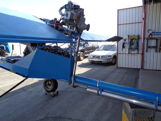

All that brightly colored junk lashed to the boom tube is the big tow strap that we used to tie the airplane to the Jeep. The tow strap looked big enough to lift a Sherman tank !
The 4" diameter silver tube under the tailboom is that Swiss Muffler I was talking about. Put it in the "woulda - coulda - shoulda worked" category. Regardless, I do need some sort of muffler, and this one actually works about as good as the stock HKS system, it just doesn't make a "wow!" difference like I thought it would.
It is the tallest Kolb I've ever seen too... that was the big plan all along, to get the wing angle up high . Nothing was custom-built or scientifically researched about it... it's just a set of taller steel gear legs from the Kolb Slingshot, with 21 inch Desser bush tires. I'm not a tall guy by any means but I can get in and out OK. The trick is backing my butt up to the fuselage side, stepping on the tire, and hoisting myself up onto the side of the cockpit (longeron). It is a little easier than it looks. I WAS wondering if I was going to have to have a one rung rope ladder or step stool or toe strap or something to get in. Turns out I don't need it.
Using the bottom of the wing as the reference, the airplane sits up at an 18 degree angle of attack (deck angle actually) when on the wheels. It's even a little more when it's on those roller skates that I use to move it in and out of the hangar.
I will indeed check the propeller runout when I re-pitch it. It may be a moot point, there is apparently no adjustment that I can make to it. I do not believe the crankshaft is bent, and there is no visible damage to the propeller hub.
In my own defense, the wing pins were only in temporarily, to get the wings out of the way of the propeller. The aircraft was NOT going to fly or even taxi on that day.

Bill; thinking about what you said about torsional resonance, and looking back through your other posts on the homebuiltairplanes.com forum, I came upon your post on that list showing pictures of your exhaust system from May 2nd - http://www.homebuiltairplanes.com/forums/showthread.php?t=28504&page=57
Looking at your exhaust system (excellent workmanship, by the way - I am envious!) what I am seeing is two stainless tubes that are rigidly bolted to the heads and also rigidly bolted to the gearbox and which extend down about 18" before they attach to a flex coupling. Given that the engine is going to torsionally rock, the flex coupling at the end of those pipes is going to be moving from side to side at what I would think to be a significant amplitude (1/2"-1" ? More? Less?) with a frequency relative to RPM. And also very likely moving the lower pipe (which goes down to the muffler) from side to side in a similar fashion.
To put it another way, you have got a couple of steel pipes sticking out (at) 90 degrees for a foot and a a half out from your engine, waving them back and forth at 1,500-6,000 cycles per minute, with a weight attached to the end of them. That might not be a source of vibration, but from where I am standing it looks like a pretty good bet...
So how can you deal with it easily and as inexpensively as possible? I don't know how hard it would be to do, but I bet if you could add a flex coupling to each pipe immediately below their attachment to the gearbox, (which would put the flex coupling just barely below/almost in line with the motor mounts) a lot of your vibration would go away.
I am including your pictures from that list just to make things simple, hopefully someone on this list can expound on this a bit more.
And if I am all wrong on this, and the pipes are not moving as I would expect, then this post was worth what ya paid for it. (I miss Buford)

A year ago I had contacted Jerry Olenik at Green Sky (RIP Jerry), and he gave me a rough number of "something about 24 inches" between the exhaust flange and the merge. That is what we built. I had actually sent HKS Japan an e-mail and got no reply whatsoever (not even a rejection to my request for info). That was disappointing, and not 100% professional on their part.
The exhaust has a "restraining collar" bolted to the bolt that holds the tailboom tube to the fuselage at the back of the cage. This restraint is like a giant Adel clamp, except it has 1/8" gap around the exhaust pipe. The concept (per my aero engineer) is to prevent the exhaust from moving much or get into the prop, but to allow it to move a little so it can adjust itself in the muffler due to movement and heat expansion. This restraint is well below the flex joint, but before the pipe bends around the tailboom towards the muffler.
I have made arrangements to borrow a prop balancer, to at least eliminate that as the culprit. I'm also going to re-pitch the prop, at the same time as checking the runout. As mentioned, there's no runout adjustment on this prop, so it may be moot.
One other possibility for the runout is that as the prop blades pass near the exhaust and the rear of the cage, there is a "dead spot" or eddy current of air that allows that blade to see a little different in-flow or out-flow, resulting in THAT blade making a little less or more thrust at that instant, causing an aerodynamic fore-aft vibration (as opposed to a mass balance problem).
thought it would.

Just a guess.  Your exhaust system design is probably causing the vibration and the engine mounts are not able to absorb them, thus transmitting then to the airframe.  With what little I know of your Kolb, I’d say it is a combination of unconventional exhaust and engine mounts.
My philosophy is KISS (keep it simple stupid).  Your exhaust system goes way beyond KISS.
If it can be disconnected at the “Y” it might be a good idea to do that.  Then test the engine isolated from all that exhaust plumbing.
I believe everyone has given you good advice.
I’m guessing you are trying to silence the HKS with the fancy exhaust.  I think you must remember that the prop makes much more noise than the engine.  So...when it is all over and done, when your engine is silenced, you still have to contend with the whiny prop noise, a trade more of ultralights.
I doubt the exhaust pipe in front of the prop is creating enough dead space to cause rough running.  Kolbs have a lot more in front of the prop than just a small exhaust pipe.
Just my early morning thoughts.  Take it for what it is worth.
thought it would.
