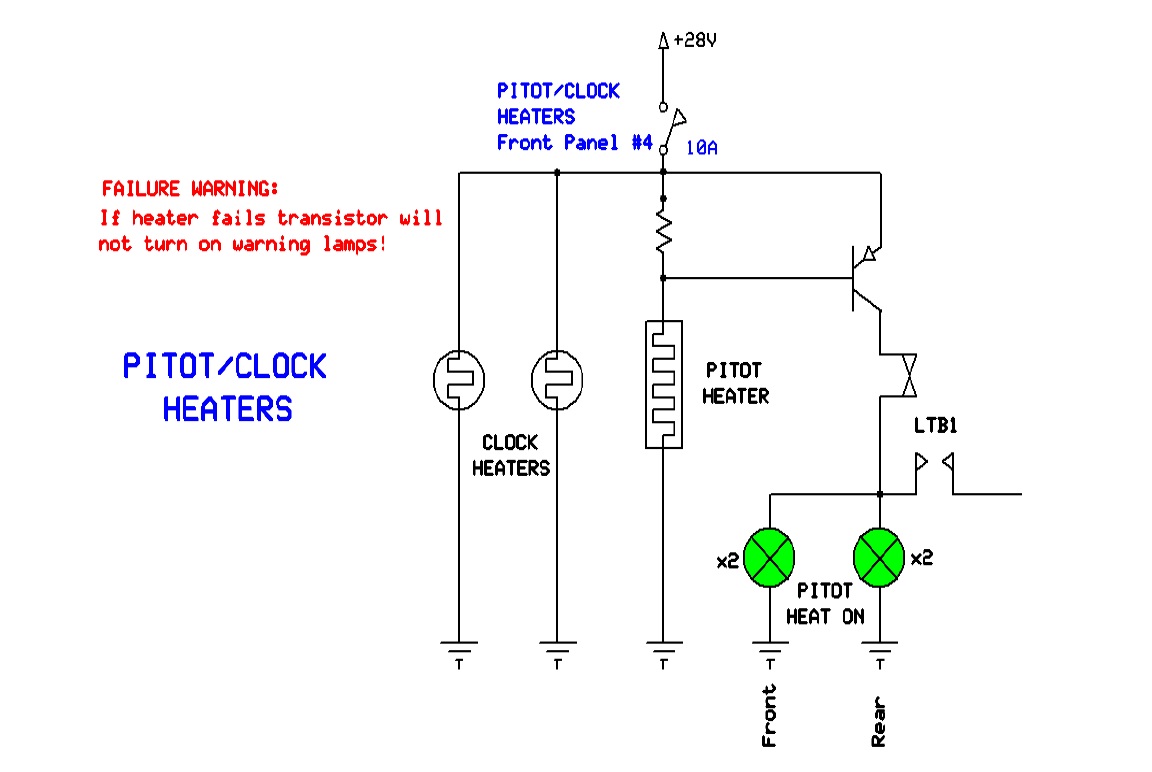

PostPosted: Tue Jul 10, 2018 6:30 am    Post subject: Re: Circuit breaker size for pitot heat? Reply with quote
FYI - be aware that the pitot heater has a simple transistor circuit that only drives the green 'on' lamps (see attached diagram) when the heater is consuming power i.e. it monitors that the heater is actually working, not just being supplied with a voltage.
So if the heater, resistor or associated wiring goes open circuit, or the transistor fails, the lamps will not light ... that could lead you to consider that the 10A breaker has died.
The resistor (T4) & transistor (T5) can be found in the relay box on bulkhead 6 (at the back of rear instrument panel) if you want to check out the circuit.
Hope this helps with your fault finding.
Rob R
