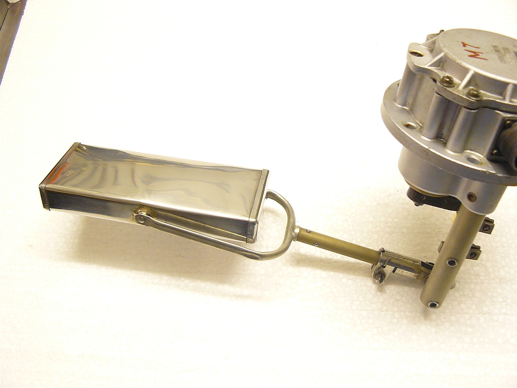

The Fuel floats in my Yak18T have dried up and no longer float. So i need some new floats or a set of complete senders. i can get CJ6 senders from Doug but i'm not sure if they are the same.

Happy to see any pics are they CJ or Yak18T?

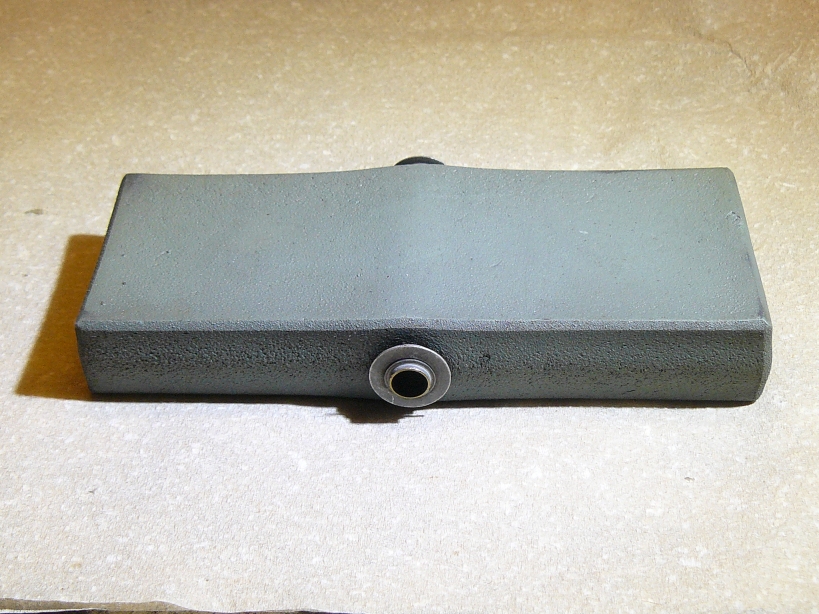

That is a typical defect after all these years. The fuel obviously dilutes any additive in the plastic floats so they shrink and no longer float. I copied a few sets in stainless but am not very keen to do some more, too much hassle and I have other projects to keep me entertained. At least some pics:

very nice! Is that Yak18T or CJ?

These are 18 T floats. Chinese aircraft are extremely rare in Europe.
