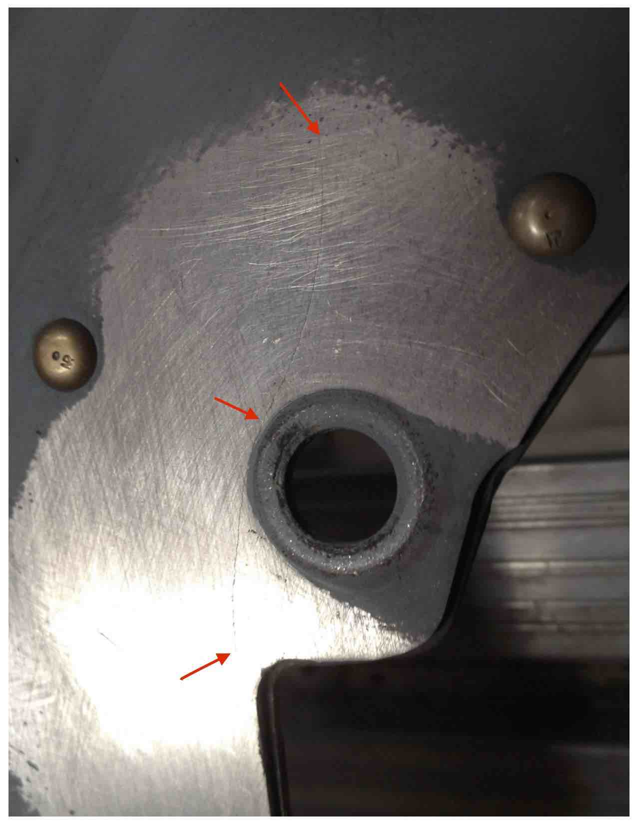

We are doing our condition inspection and found some very faint cracks around the bolts that pass through the backplate, S 602B. In fact they are so faint, that we had to clean off the primer and do a fingernail test. Anybody else had this?

Curious, are the cracks in the fiberglass of the spinner or the aluminum backing plate. Pics?

The fiberglass is fine - it's the aluminum backing plate.

I haven't seen that, but since it's the aluminum, I would suspect
vibration/out of balance. Obviously, replace the plate. But before you do,
maybe slowly run it up while feeling the dash for vibration? Get someone to
electronically balance your prop on the plane to check it out after it's
been replaced? We've got a guy in our EAA chapter here in Greenville, SC
that gives a group rate for balancing if several want to do it at one
sitting.

Could be that the bolt holes were not de-burred correctly and micro cracks turned into something more!

As requested, I took some photos today. We also pulled the assembly and found cracks at every bolt - on both sides. I've ordered new parts, but it's obvious that it was just a matter of time. I will attach one sample photo, they all look pretty much the same.
