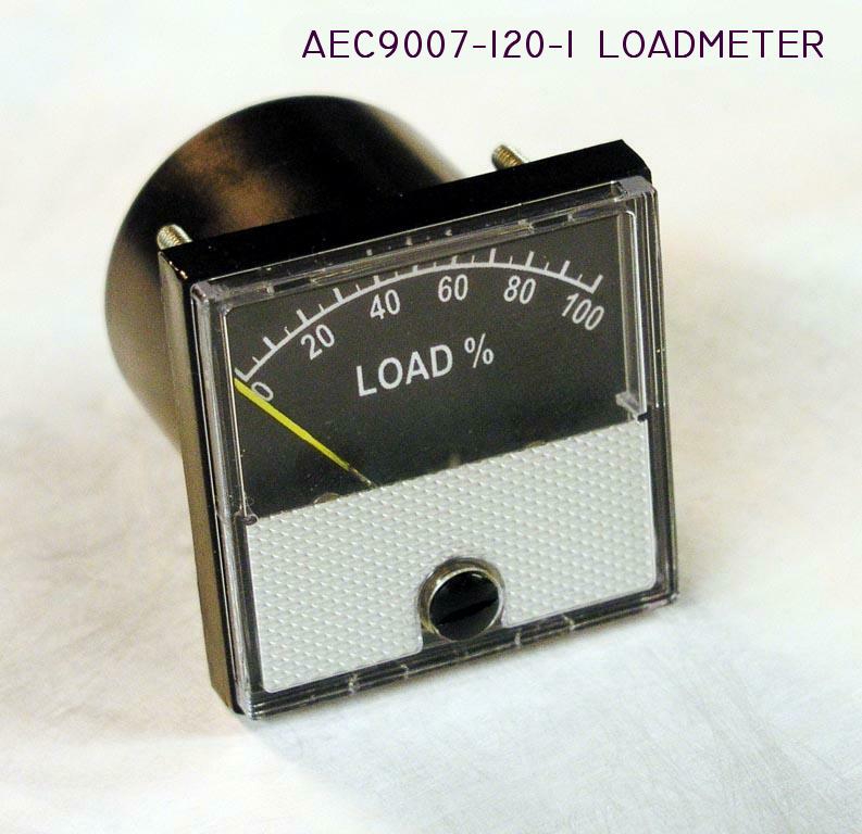

[img]cid:.0[/img]
I've got a couple dozen of these instruments left over
from the AEC9007 days. These can be paired with an appropriate
shunt to show read time loads on the PM/RR system.
[img]cid:.1[/img]
Sort term operations at or above 100 percent would
be okay, like to recharge a battery that has started
the engine and then supported electrowhizzies out to
the departure runway.
I was remiss in the omission of a second
prophylactic which is load analysis confirmed
by experience which shows the PM/RR system is not
going to be overtaxed by predicted, normal
operations. If you have verified that normal
ops loads are within system ratings, then
failures can be assumed to be caused by
abnormal conditions like lack of regulator
robustness, attempting to recharge a really
depleted battery during flight ops, shorted
cell in battery, etc.

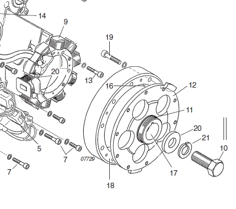

PostPosted: Mon Jun 11, 2018 9:04 am    Post subject: Rotax Charging System Reply with quote
At 11:21 AM 6/11/2018, you wrote:
Oh, well that explains a lot. I thought it was a "generator" with brushes making DC current.
The only place brushed generators are used these
days is on turbine engines where the motor that
starts the engine becomes a generator when the
engine is running.
If it's a piston engine, the power source will
be some form of alternator. When the alternator
is built into the engine, it will generally be
a Permanent Magnet device. On the 912/914 Rotax
engines . . .
[img]cid:.0[/img]
A stator assembly (9) carries the power generation
windings along with special coils that power dual
ignition system. These windings are 'charged' by
magnets in a flywheel hub (1Cool on the crankshaft.
