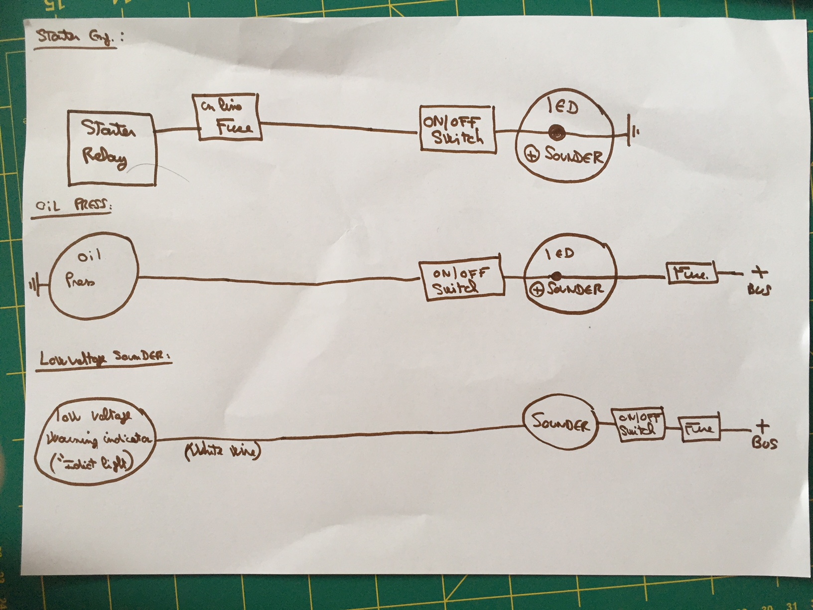

Maybe a bit late, but...
Lots of options and how smart you want this to be.
Cheap and easy way if you know a bit of C might be an Arduino... Depends on your input voltages and what IO you need...
It can turn on a bi-color LED - RED for bad stuff, yellow for alerts...
Even do voice messages with the addition of an appropriate wav module...
What do your inputs look like and what outputs do you need? (Voice, 1 LED, multiple LED's?)
Achille
Joined: 12 Jun 2017
Posts: 25
Location: Europe
PostPosted: Fri Jun 01, 2018 7:57 am    Post subject: Re: Alarm souder with multiple sources Reply with quote
Thank for your reply andy, i did not see it.
I was thinking about more easy and simply gadget. Just with buzzer and led.
I have done a drawing for my 3 systems alarm to begin, now I have to set it in a more conventional way. (to do not have 3 sounder, and 3 switch to mute them)
- Starter still engage
- Oil press low
- Sounder from my low/high voltage "idiot light" (has an option to wire a buzzer)
I was thinking to use simply diode in each entry and the only one switch/led/sounder ? But it's not my best matter electronic. Mainly to set it on a plane, don't want to do a mistake.
I anyone have an idea... or advice. Wink
