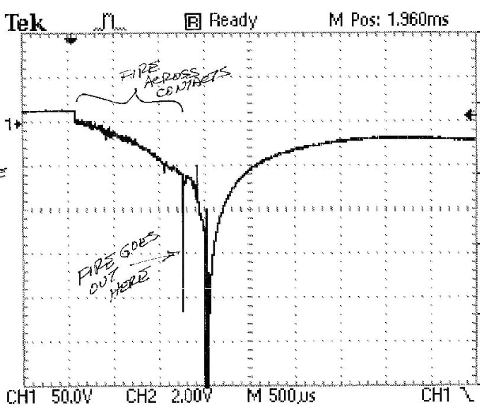

At 08:24 AM 5/28/2018, you wrote:
Bob,
curiously enough mine's a Europa too. Could it be something to do with composites?
no . . it would have happened in an RV too
Another Symptom which might help the discussion. The CB tripped ONLY at the moment of switching off the ALT. It could be reset immediately after with no ill effects suggesting that it was something to do with the switching off itself that caused the CB to trip.
Yup . . . that's how the transient event is
created.
[img]cid:7.1.0.9.0.20180528140202.0205f138(at)aeroelectric.com.0[/img]
When the controlling switch opens, the magnetic field
in the relay collapse very rapidly (~3 milliSeconds
in the plot above).
