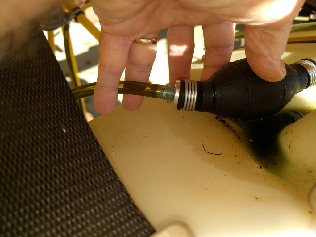

I bought a 6mm primer bulb on Amazon last summer for my Twinstar project. IIRC, it was installed in my fuel line in October. It's only been used a couple of times since installation. I've run less than 3 gallons of gas through it, using only non-ethanol premium car gas with two stroke oil. This morning, I noticed fuel standing on top of the tank, under the primer bulb. The bulb has completely dry rotted, with one end cracked almost all the way through.
Here's the link to avoid:
https://smile.amazon.com/gp/product/B01LCD8I9I/ref=oh_aui_detailpage_o08_s04?ie=UTF8&psc=1
Now, can anyone recommend a quality primer bulb for 6mm fuel line?
Charlie

After a broken flapper valve put me back on the ground just seconds after take off I went searching for a better quality primer bulb. That was twelve years ago. Short version, all I could find was "Hecho en Chine" crap. Even the supposedly "good" one from CPS was junk. If you have an electrical system replace it with a Facet pump. That's the surest, safest way to go.

Primer bulbs are famous for failing, on the ground and in the air. 1997, while on a flight in the Firestar from Alabama to Miami, I had an engine failure over Sebring, FL. Only place to go was the football stadium at Sebring High School. I made it into that tiny spot and got stopped. The Lord was with me that day. No brakes installed on the Firestar at that time. The primer bulb stopped passing fuel and the pulse pump pulled it flat.
If I was going to run a primer bulb I would spend the dollars and buy a name brand, i.e., Honda, Mercury, etc. I like Honda. Had one on a 90 Honda outboard that was very old. When I sold the boat it was still in good shape. The price will scare you when you go to buy a replacement.
Usually, in my experience, it's the little things that bring you down more than catastrophic failures. Murphy is always lurking, waiting to do his dirty deeds.

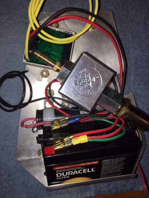

I agree with you guys. A facet electric fuel pump is the way to go. I don’t use a electric starter so I run it off a small 1.3 amp AGM battery that charges off the rectifier regulator with capacitor in the charging circuit to balance the voltage output. I didn’t figure this stuff out. It’s all thanks to you guys on the Kolb-List . Gotta go with experience. [img]cid:E7F49C55-248E-496D-AEBC-DABAB3C9B78B[/img]
I’ve since relocated the battery to the nose but the system remains the same.George Helton

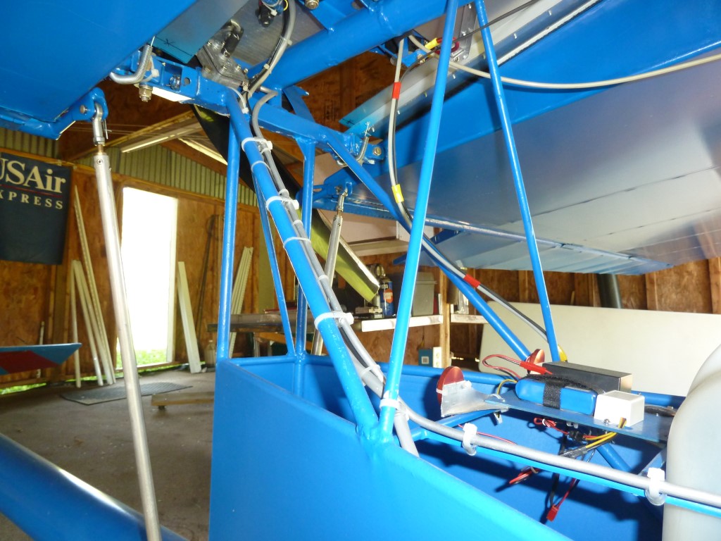

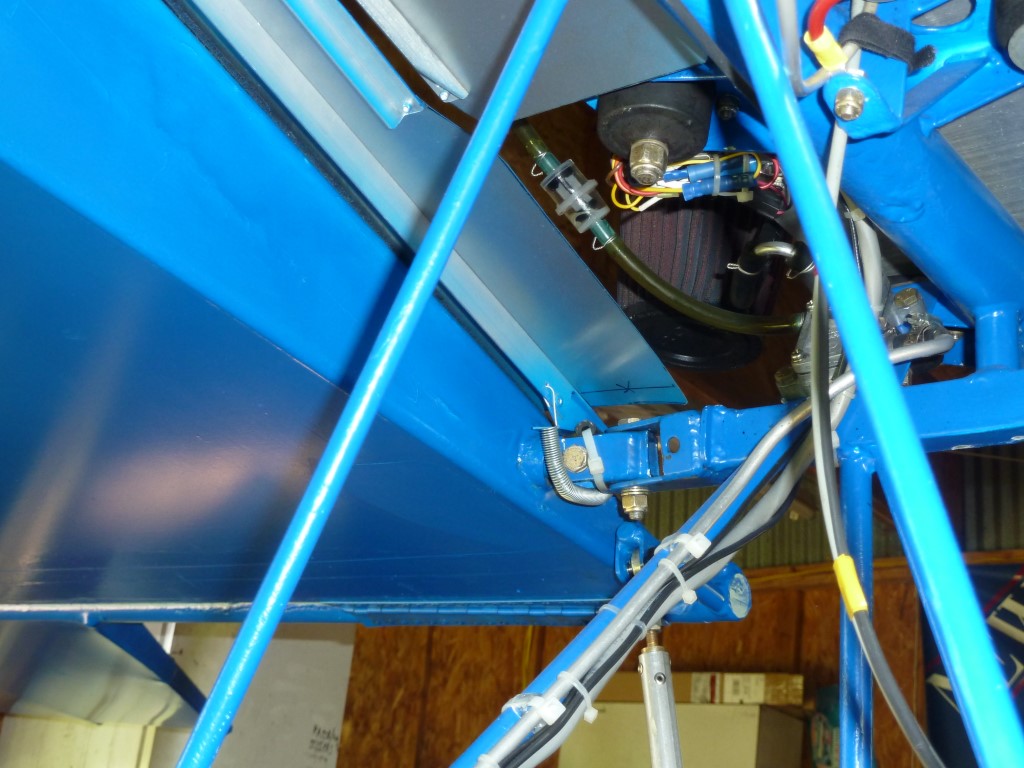

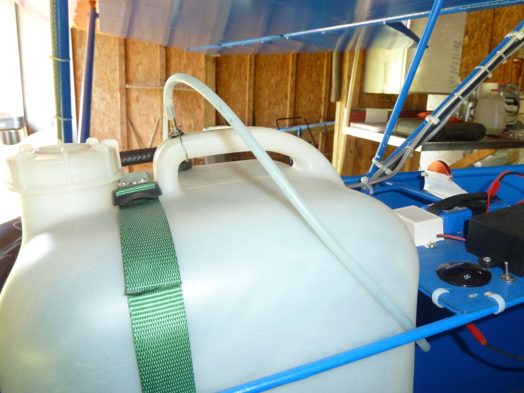

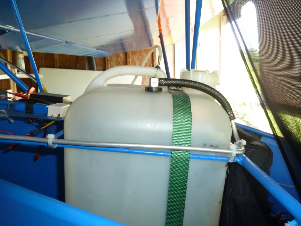

Facet is the way to go, unless you don't have an electrical system. But even w/o an electrical system, you don' need no steekeen primer bulb...
Hard plumb the system as much as possible. Good quality rubber fuel line from the tank to the aluminum fuel line, run that aluminum tubing all the way to the fuel pulse pump. Run clear urethane line (so you can see the fuel going through it) from the fuel pump to the carb and replace it annually.
Solder a piece of brass tubing to a brass washer and used a rubber grommet to make a fairly airtight connection to the tank; this is your vent opening. Get a long enough length of model airplane fuel tubing to fit snugly over the brass tube and reach to the side of the fuselage.
To prime the engine, blow into the model airplane fuel line until you see the gas start to flow out of the pulse pump toward the carb. Now pinch off the model airplane fuel line and hold it for a minute until the float bowl has time to fill. Walk around to the engine side and verify that the fuel line is full, if the fuel line is full, probably your float bowl is too.
