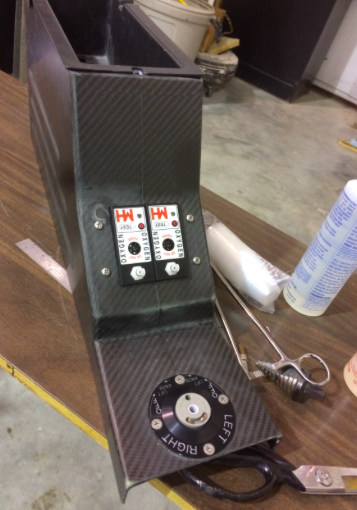

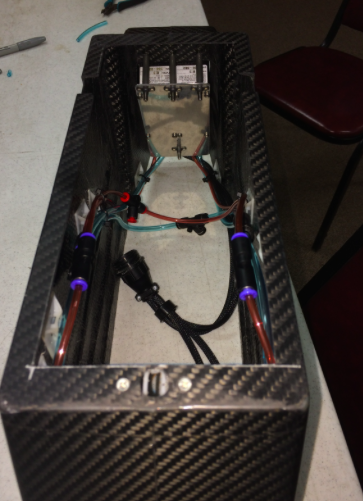

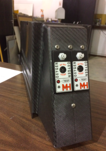

I put mine in the center console and I regret it every time I fly....   Finding another location is something I'd like to do at some point in the future.
My thought process was to put the headsets, oxygen outlets, and misc cables (USB, Cigarette lighter, etc) near the center point of the cabin.  It would serve as the distribution point to all 4 seats and the cables/hoses would not be a factor when exiting the airplane.
What I can tell you is that it's a nightmare to pull the console to inspect/service the tunnel.  It's a nightmare to get the cables/hoses re-installed in a consistent enough fashion where the interior bin will sit down flush and where the rudder cables won't rub against them.   I really regret putting anything in my center console.  I should have left it naked and when on finding a different spot.  I constantly have mess of cables/hoses to fight through.  I've also found that with that many wires/hoses in the box, things (wires and hoses) get pressed into position and it binds them.  I currently have an electrical gremlin in my pilot outlet that I need to trace.  I am 100% sure it's a connector issue but when you can't permanently mount the wires and forget about them, things like connector problems happen.  That area is just too dynamic from maintenance period to maintenance period to expect everything to be rock-solid all the time.

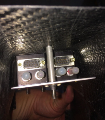

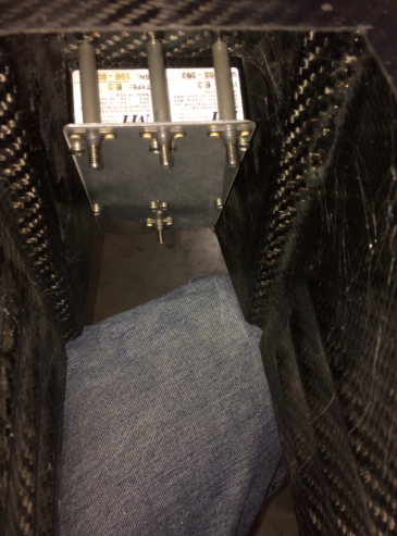

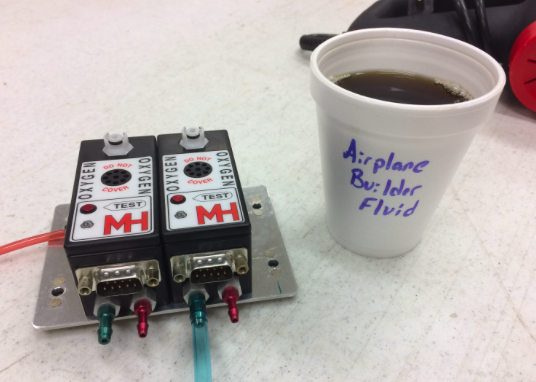

If you do decide to install in the center console, I've attached some pictures.  The factory backing plates on the outlets were too wide to allow side-by-side installation of the outlets in the width of the console.   So I had to remove them and build a single backing plate that allowed me to squeeze the two outlets closer together.  Worked well.
The overhead air console is probably a good choice, but I know MH wants you to mount them in a place that has static cabin pressure.  I know the sensor is on the face of the outlet, but I still think it would be a good idea to build a receptacle box in the overhead to hold them, then seal that box with proseal so it won't be subject to the positive pressures inside the overhead console.  That's something I'm still considering as I'm not real happy with my center console setup.  I just have too many wires and not enough space.  Good luck!

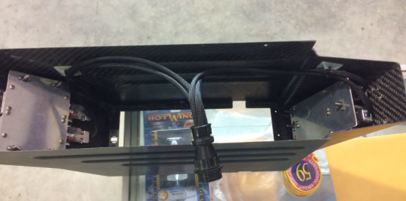

Thanks for the pix and insights. In my flying -10, I did much the same thing except I have a flange mounted CPC on the tunnel cover under the consol. To remove the consol, I simply unscrew the CPC and the whole thing comes off as a unit.
I do have O2 ports on the front of consol as well except these are strictly outlets (no electronic heads) as they predate the new MHS system. I only have a single quick disconnect on a supply line to break.
I plan to do the same thing again on the center consol using a single CPC. I don't want to put O2 on the console this time due to the additional wiring and connections associated with the distribution head. Also, I like the real estate for jacks etc.
Based on you comments I'll find a different home for the O2 distribution heads.
Lastly, my airplane builder fluid looks equally dark but generally says Guinness and comes in a can.

If you look closely, I used a CPC too. No way I’d try it without the CPC. Just too many wires to my use one.
