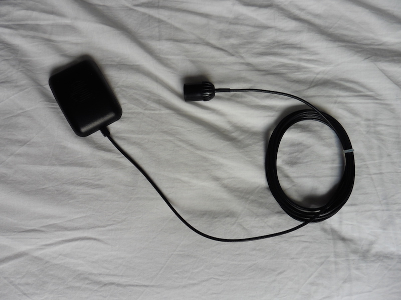

This is a question for avionics gurus. After one full year of good service, my G5 EFIS with its enabled internal GPS antenna started to display wrong attitude information. After talking to the G3X team at Garmin, a software update fixed the issue, but after reviewing the recorded data of one of my flights, they came back to me and suggested I install an external antenna to improve the GPS reception. So I purchased a GA26C antenna (picture attached). The antenna comes ready for use with an 8 ft cable and BNC connector. I need only 2 ft to install the antenna on top of the instrument panel, therefore my questions: performance wise, is there an inconvenience to install the antenna as it is and attach the loops of extra cable length together? Is it worth cutting the extra length and install a new BNC connector? Would that reduce possible losses and/or susceptibility to electromagnetic interferences ?
Remi Guerner
 Filesize:  133.88 KB
 Viewed:  19351 Time(s)
rlborger(at)mac.com

Just my 2¢. If you ask the Garmin folks they will insist that you not shorten the wire. As such, just loop the excess and tuck it away under your instrument panel.
Many years ago I upgraded an original Garmin to WAAS and the replacement antenna came with about 4 meters of cable. The instructions forbade any attempt to shorten the cable as it would negatively impact the signal from the antenna. So even though a meter of cable would have been more than sufficient to go from the Garmin to the antenna perched on the top of the instrument panel, I had to loop the other 3 meters and tuck inside the panel.
I’m going to guess about why. It may be because many GPS antennas are powered and have electronics associated with the antenna. The cable length may be to provide proper impedance matching from radio to antenna electronics. Any other comments are welcome.

I think you are right, reducing the cable will reduce losses but 8ft is not that significant. The introduction of a connector will introduce impedance mismatches and losses that would probably amount to more. I would leave as is and avoid tight bends in the cable.
Hi Remi,
Your question seems to imply that you are using a Garmin G5 unit.
Are you aware of this observations on the A&S Questions and Answers about this antenna model ?
Can the GA-26C be used as a remote antenna for the Garmin G5?
No, for the Garmin G5, you will need the GA 35 WAAS GPS.
That being said, how about first trying an antenna as-is before undertaking any surgery on the coax ?
Amicalement,

Before you cut anything try it in your new position and ensure it has the desired improvement.
If you can terminate with the correct, crimped connector, then you wont introduce any additional impedance change or effects and it will reduce the amount of cable clutter behind the panel, it can become a bit of a nightmare with some devices.
If you cannot terminate with the right tools for the job, I suggest leave alone and loosely coil the cable, don’t crush or kink the coax as that will change the impedance.

[quote]Can the GA-26C be used as a remote antenna for the Garmin G5?
The G5 Manual recommends the GA26C among others for non certified G5 installation.
A Waas antenna is required only for certified aircraft only but the cost is not the same.
On the Europa you need to remove the whole panel module to do that.
So better do it right on the first try!
Remi
Understand.
Ouch !
Any slack in the wiring to allow behind-the-panel access without too
much hassle ?
Then as advised, keeping the excess length neatly stored in a loop seems
the way to go.
Please note that to minimize interference issues, the smaller the area
of the loop the better. That is while preserving safe bending radius for
the coax.
You can also twist the loop in a figure 8 without stressing the coax.
See https://support.agleader.com/kb_upload/image/coax4.jpg.

Thanks to all who have responded to my question. I will install the antenna with its full length cable bundled as recommended by MGL.
Remi[/quote]

I installed the Garmin 430W in my Europa and it came with the eight foot cable. I was told not to coil it. I place the antenna just above the Hat Rack on the D bulkhead, inside, then place the cable around the edge under the co-pilot's door ledge and then under the baggage floor then up to the antenna. The 430 has worked beautifully.

Panel mounted EFIS units with internal GPS antennas are prone to interference depending on installation.
I’ve always used an external antenna in my practice. I mount them to a metal inverted hat shape to the top inside of the panel. Early WAAS GPS antennas (those less expensive much lighter plastic type) work better when attached to a metal surface. The large, heavy Garmin types have a metal base so a simple fiberglass mount in the panel works OK. The Europa, being fiberglass, does not impede radio signals but the surrounding metal globs around these items do. The proximity of other receiver antennas for some reason do not seem to bother one another. Go figure.
As far as antennas, I have always made my own BNC cables and connectors and never have had a problem once ohmed out. RG 58/400 cable is fairly bulky and are easy to make to proper length. Manufacturers normally resist allowing amateurs to modify their cables for obvious reasons, but if you have the tools and know how, shortening a cable is perfectly fine. I just prefer to remake the cable completely. The small S type connectors and antenna wire, I coil up (because it is a small flexible wire) and I place the coil in the panel away from the GPS antenna and all is fine as long as the coiled antenna wire is not wound around the antenna. (I put mine along side the EFIS unit as its metal case should prevent interference.) If you coil your antenna wire, just use care where you put the coil. Between the Garmin/Blue Mountain/EFIS of choice and the altimeter has always worked for me. Be flexible, because if it doesn’t work in one spot it may in another. Too bad the panel has to go in and out if you are wrong.

GPS antennas contain not only a GPS receiver but also an amplifier. The length of coax is specified to reduce the signal strength to the proper level for the device processing and displaying the information, such as your G5.

I will put on my EE hat and surmise that the reason that Garmin
advises against chopping your cable is a simple one.
GPS RF is on the north side of 1.5 GHz. Quality cable like RG400
double braid is essential as is perfection in creating the tiny crimp
connections. If you do not have the equipment and expertise
to do the work, don’t even try it. These are not your father’s
PL-259/SO-239 radio shack connectors. A bad connection will
have more attenuation than a few feet of RG400.
The dc voltage to the preamp is not a relevent factor, as
a rusty nail could carry that.
Yes, I think we have all heard that trope about specific cable lengths.
It is, IMHO, just marketing nonsense with no technical basis, since A) the
lengths are no where near a tuned wavelength Feedline, and B) All
modern receivers have AGC(automatic gain control).
