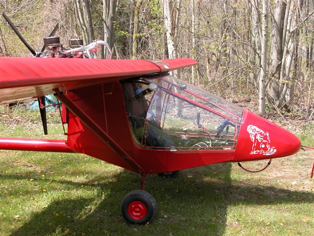

Dennis at the Kolb facility is making up an aluminum 18 gal. tank for the 3X . I'm not fond of a fill in the interior of a fuselage so am looking for ideas for an exterior fill. Rural nature of use will require fueling from cans at least half the time so underwing location doesn't seem too feasible..... has there been any success mounting one below the engine through the aft flat area of the fuselage or vertically through the center section? At this point the tank and fuselage fittings can be located wherever works best.

PostPosted: Sat Mar 24, 2018 9:36 am    Post subject: Mk3 Xtra Fuel Tank Install.... Reply with quote
Mike, see if you can find a pic of John Hauck’s fuel tank, mounted
high inside the fuselage. after 3000+ hours it obviously works

Mike
I have a filling system like you have proposed. It is in a higher pressure area so you don't have to be worried about fuel flow issues if the seal gets compromised. I used a boat fuel filler that also has a vent for venting when filling and fuel delivery. I do caution that the angle of the tube back to the tank is low so there can be some burping of fuel if your fill too fast. Using 5 gallon cans is never a problem but filling with a huge airport fuel nozzle takes careful use. Also Lexon doesn't like fuel being spilled on it.
I can send a more higher res photo direct if you need it.

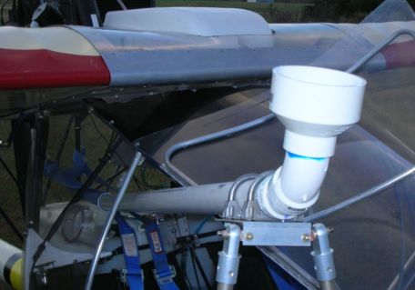

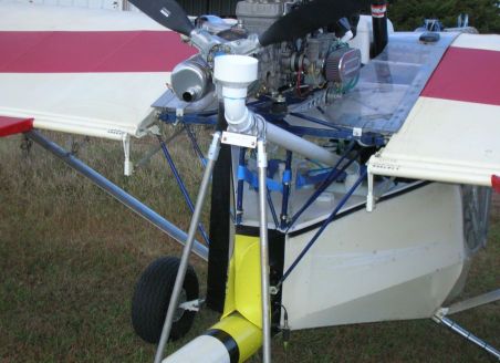

PostPosted: Mon Mar 26, 2018 7:01 am    Post subject: Mk3 Xtra Fuel Tank Install.... Reply with quote
I have the standard plastic tanks in my Mk 3. It was the bending over that
just did me in trying to fuel and after several tries I came up with this.
It's mostly PVC pipe with some odds and ends from strategic resources (junk
pile). The legs are titanium from a piece of tubing from Boeing Surplus and
the fittings are some old hang glider parts. Works well and prevents spills
Richard Pike

PostPosted: Tue Mar 27, 2018 5:48 am    Post subject: Mk3 Xtra Fuel Tank Install.... Reply with quote
That's odd. Both pictures are there in my copy. I shall try again.

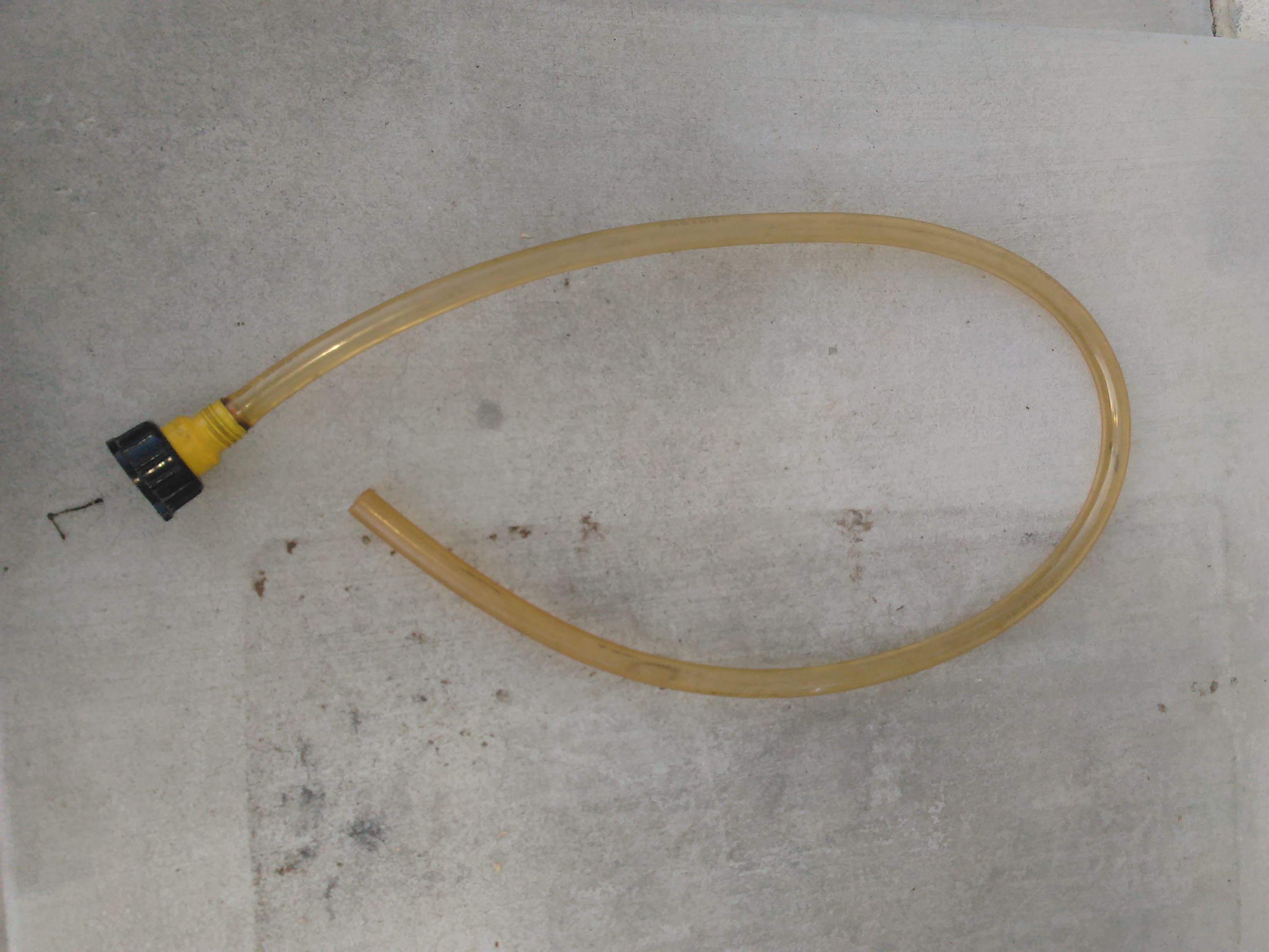

PostPosted: Tue Mar 27, 2018 5:59 am    Post subject: Mk3 Xtra Fuel Tank Install.... Reply with quote
I came up with a simple fix to fuel my mkiii.    I made an extension to fit my gas can nozzle.   With the 5 gal gas can on the ground the extension will go to the bottom of my 16 gal alum tank.  I lift the fuel can to my shoulder, grab an exposed alum hinge to eliminate static.

PostPosted: Tue Mar 27, 2018 6:12 am    Post subject: Mk3 Xtra Fuel Tank Install.... Reply with quote
A friend of mine who owned a Pitts S-1 was fueling it from a 5 gal can as I walked past his hanger.  This was many years ago.  I was amazed at how simple his fueling system was.
His fueling system consisted of a plastic 5 gal can and 6 feet of 3/4" ID plastic tubing.  The tubing was pushed on to the nozzle of the can.  Stick the tube in the fuel tank, lift the can higher than the nozzle and you are home free.  On long cross countries I always carried that tube.  Now days I carry an Alabama Credit Card which uses the little shaker valve to start siphoning fuel from the gas can.  I usually sit the can on a folding ladder, if available, or on top of the engine if all else fails.
Since I have gotten older, I usually don't try to save money fueling from 5 gal cans.  Lots easier to fill from the 100LL pump.
Experimenters come up with unique ideas to accomplish what they need to get done.

I thought about fuel pumps for transferring gas, but quickly discovered an easier system. Anyone ever heard of a siphon? Now I don't like to get a mouthful of gas either, but with some thought beforehand, tasting gas isn't necessary.
I use older Rubbermaid 5 gallon gas cans. Lift and rest the can on wing or ladder to a height of at least the height of the gas tank filler opening . Insert clear plastic tubing to the bottom of the gas can with other end into the airplane fuel tank. With any vent on the gas can closed, wrap thumb and first finger around tubing at gas can neck, creating a semi-seal and leaving just enough space to place your lips to blow into can to start gas flow.
When I see the gas can is near empty, I start tilting it point the tubing onto one corner to completely empty the can. Works every time with no gas tasting.
