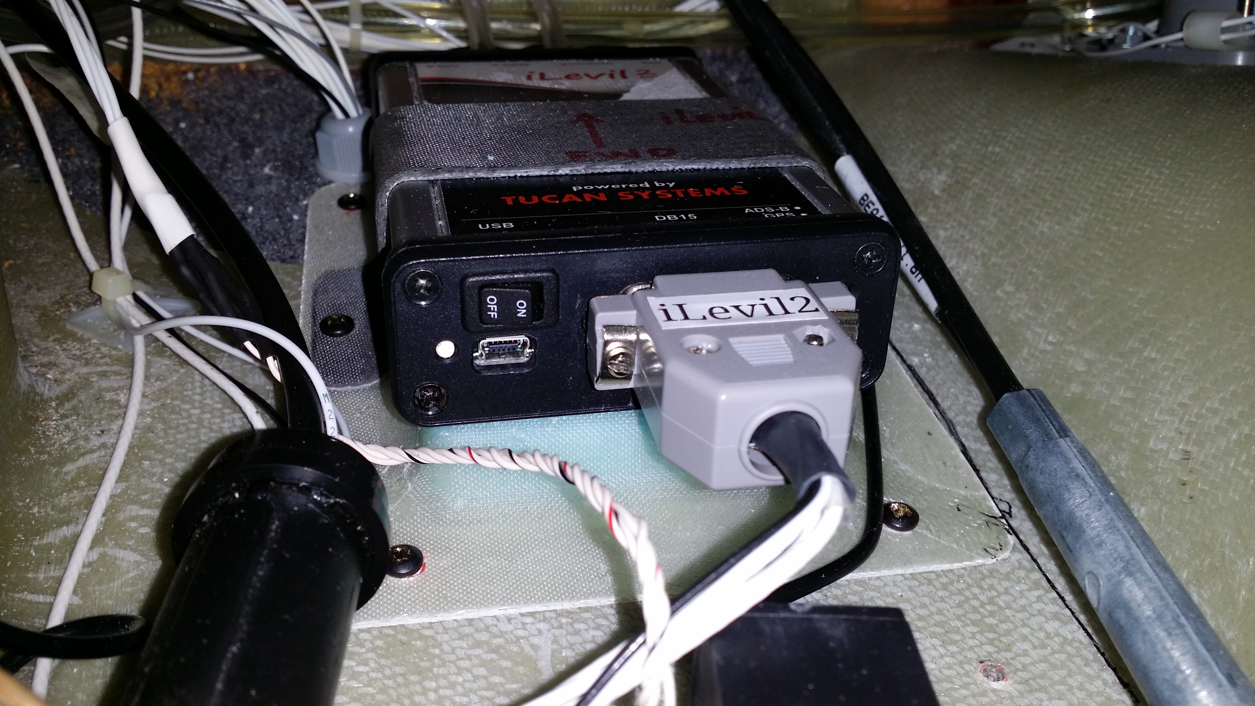

Hi Bill,
I've put mine behind the RH panel on top of the tunnel and on top of a foam/GF fabricated 'wedge' to bring it level in flight. Actually there is an article in with Tony Wickens that i expect will be published in the EF. Despite 'seeing' the UC frame, it seems to work fine so far. I've tried to attach a pic to this message that illustrates . . .
