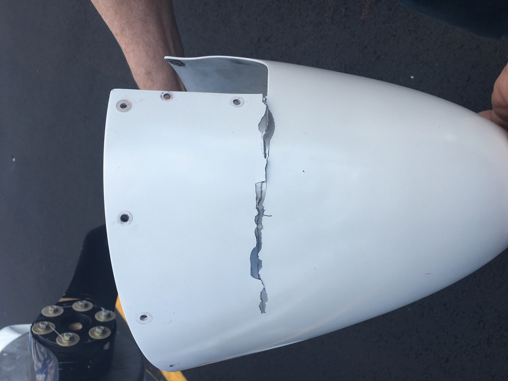

N660C, OC's plane, has been cracking spinners. Do any of you more experienced folks have any idea what may cause this?

What spinner is on the plane? The original kit came with a fiberglass
spinner. I believe OC was using a Prince prop which I am using but I changed
to an aluminum spinner with a forward bulkhead and have had no problem. The
original FG spinner did not have a forward bulkhead and would go into
vibration once in awhile which was irritating but it didn't crack.

The FG spinner cracked so I put on the aluminum one pictured but it had no forward bulkhead. Any idea where I can get another one ... with the forward bulkhead?

I ordered mine from Aircraft Spruce, you need to give them the prop hub
thickness.
