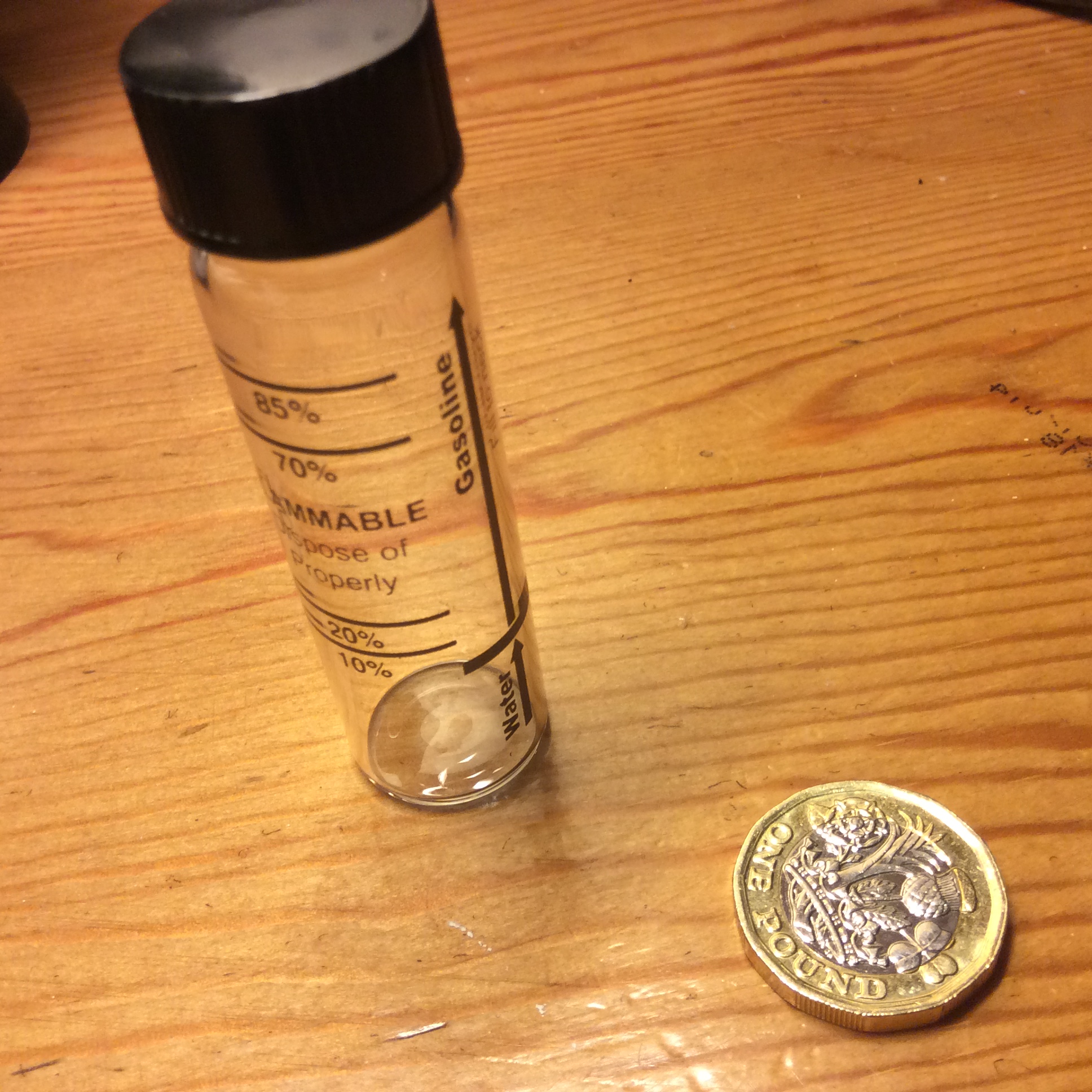

PostPosted: Mon Mar 05, 2018 12:58 pm    Post subject: Re: TL2.26 use of mogas - anyone been through the LAA hoops? Reply with quote
I use a Briggs & Stratton gasohol tester.
Sadly not stocked by any of the big people in the UK.
But you will find them for sale at good quality Lawn Mower Repair places.
They last forever and cost between £1 and £2.
