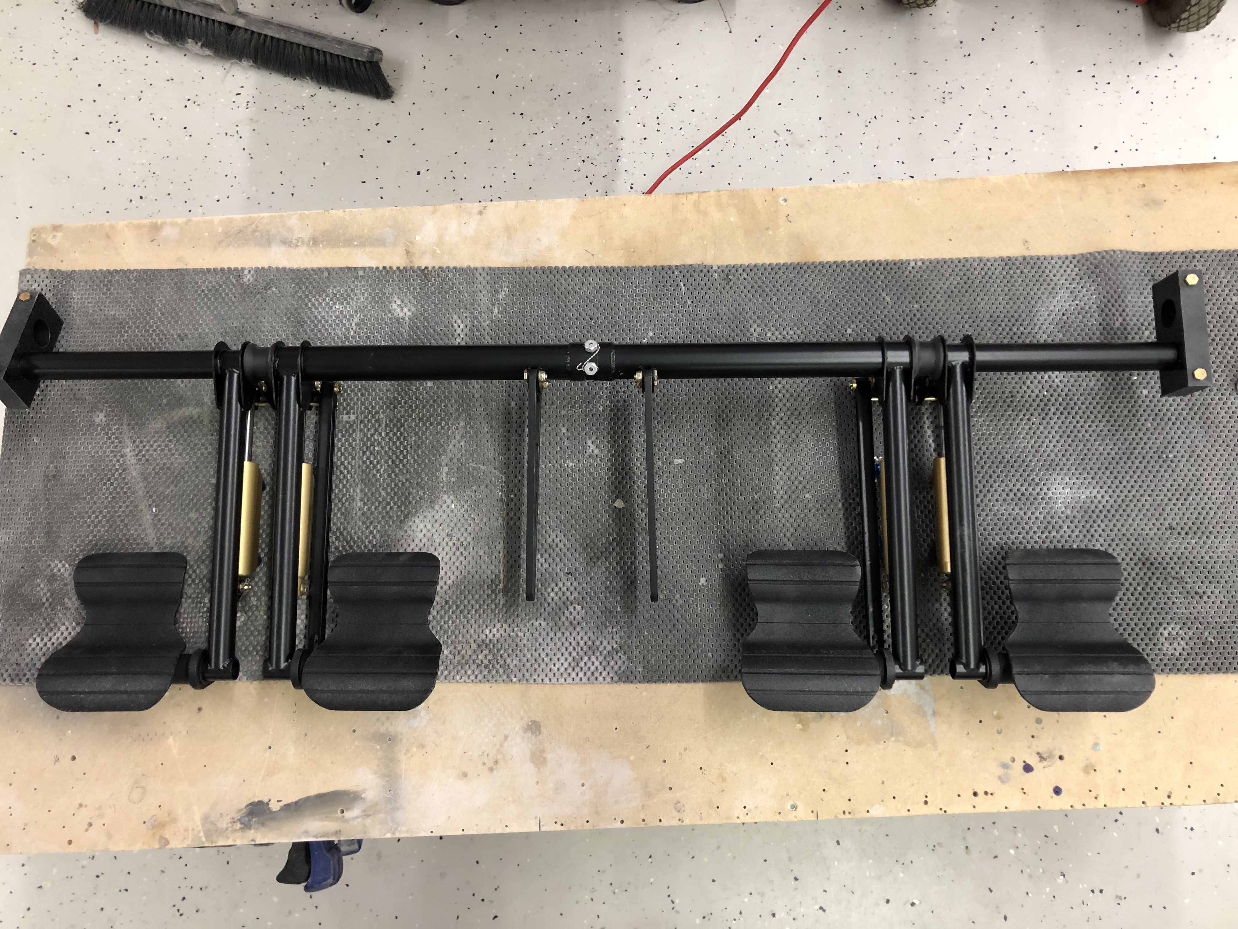

Hi
Everyone knows that VANS makes a great kit. That being said, some of the kit components do seem like that they are ex the iron works of Mordor.
IMHO, the rudder pedals and brake lines supplied as part of the VANS kit really don't do the -10 justice. In my flying -10, I installed Paul Grimstad's after market pedals.. I have been very happy with them. They really look like they "belong'".
For my current project I went back to Paul and got his current pedal iteration. It is lighter and equally appropriate in a -10 fuse.
For those interested, here is a link to his website: http://controlapproach.com/products/experimental-aircraft-products/rv10-rudder-pedal-system
Cheers
Les

I am most happy with my Control Approach pedals.
Sure grip for feet.

Les,
They indeed look nice. No prices on the website that I could find. What did they set you back?

Just under $2k

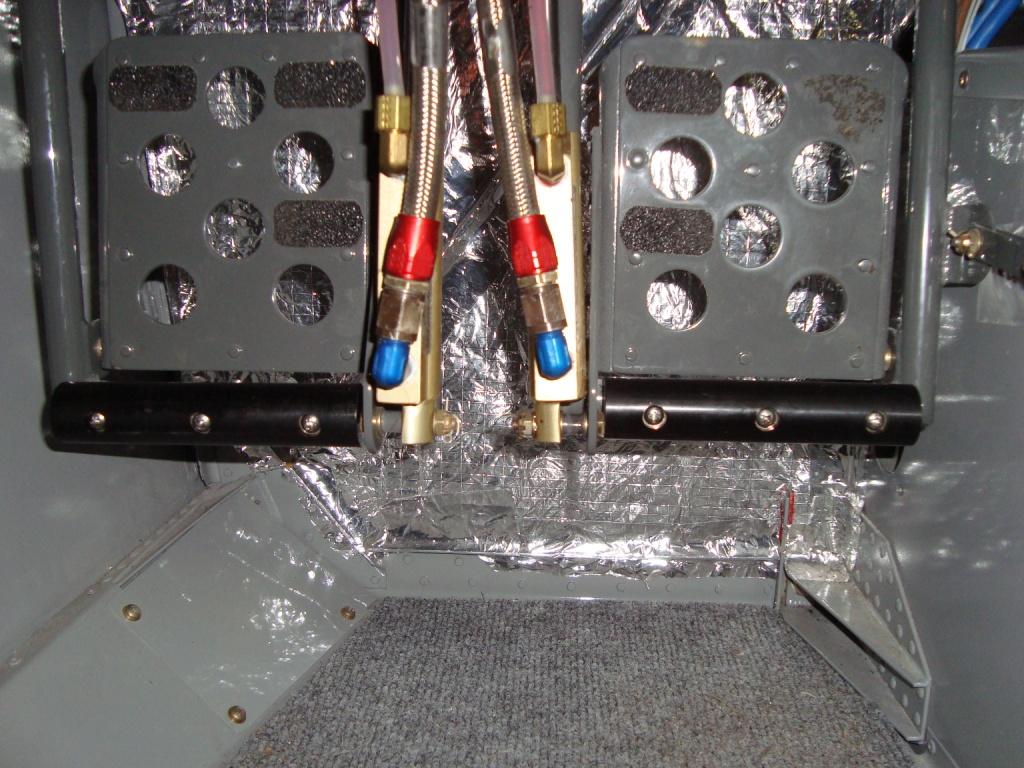

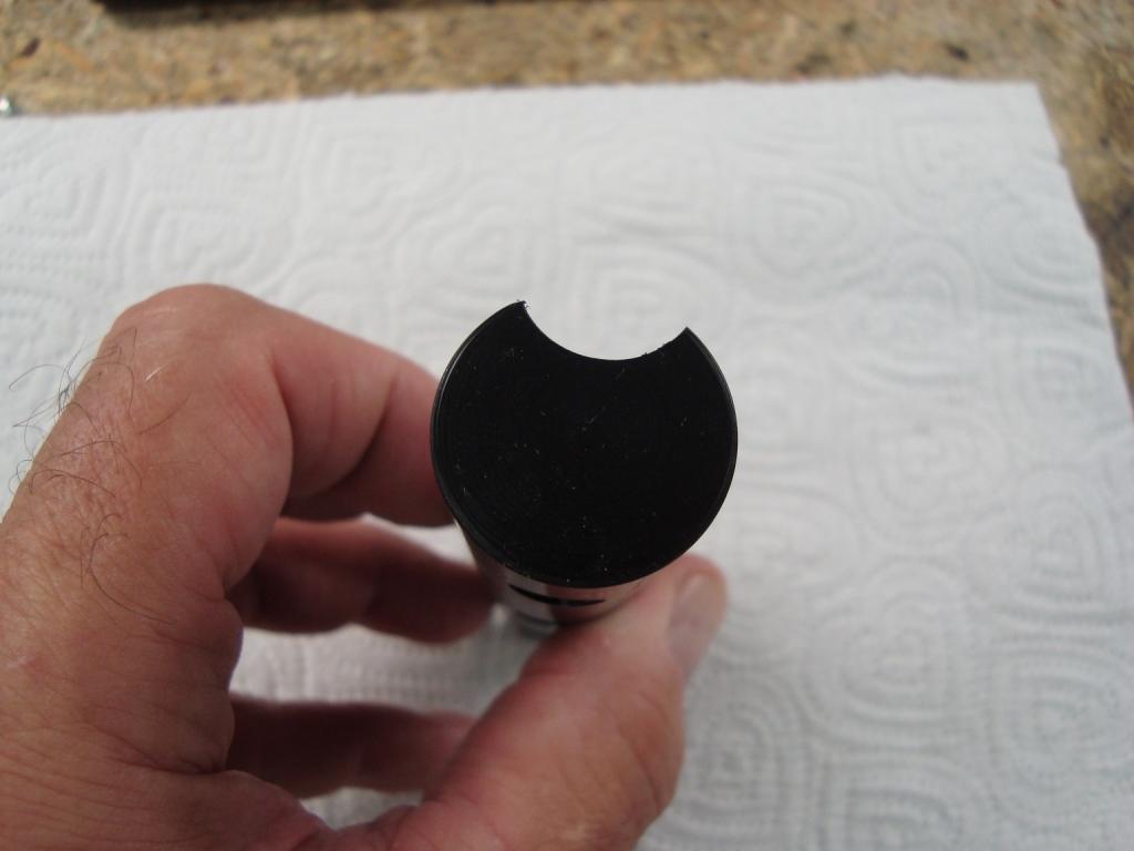

I find the stock rudder pedal setup works just fine - after I added a simple
extension to keep my toes off the brakes. I buddy of mine made these on his
milling machine. He still has the pattern if anyone is interested.
$2000 will buy a lot of avgas.
Carl

I'd agree.  I've never found them aesthetically unpleasing and they work
just fine.  In my case I don't even have the extension and don't have a
problem
keeping off the brakes.  Plus they do make those aftermarket rubber pedals
with upper and lower push areas, if someone really has to have that.

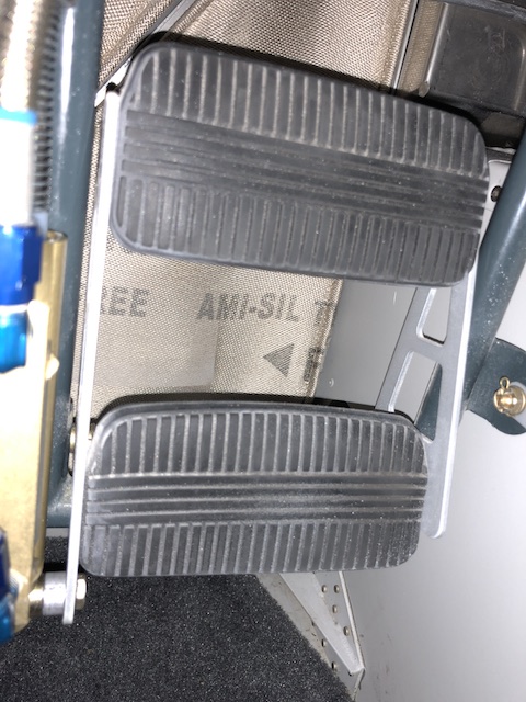

I have these pedals (photo attached). They work great, but still don’t fix the sticking master cylinder issue. Just recently had some badly warped rotors because of dragging brakes.
Saw someone put plastic Heyco bushings in the lightning holes of their stock pedals. It make it look really cool, and probably saves the powdercoating from wearing off.
Lenny

I'm curious, how are those pedals balanced as far as a tendency to tip forward or aft?
Not being critical at all, just wondering.  I know that when I added the pedal blocks
to mine for the girls, I set them up and they actually are weighted so that they would
help to retract the pedal.  I also remember people in the past adding return springs
to the master cylinder.  (is that what I see by the hose on the picture?)
Is it possible that the weighting of the pedal maybe assisted in adding to the
brake drag?  Just thinking out loud.  If that were true, maybe a slight change in the
position of the lower pad could make a difference.
I've not run into problems with the stock setup, but I know people who have,
and I've always been curious as to what would be so different.  I know that
a few people have gone to a singe long hinge bolt, and I know that over tightening
the bolts can really be a big problem. But other that that I can't find any
serious flaws in the stock system.  Van's did improve the pedal itself in the
RV-14 kit, so for new builders, you may want to swap parts for the
actual metal pedal itself. from the -14.  Everything else is the same.
Tim
Lenny

The pedal geometry is exactly the same as stock. I haven’t checked their balance but that’s a good point.
I did add return springs and they seem to be helping, but I’m going to switch them out to clock springs, cause according to Matco the current ones are eventually going to wear out the master cylinder shaft.
Lenny

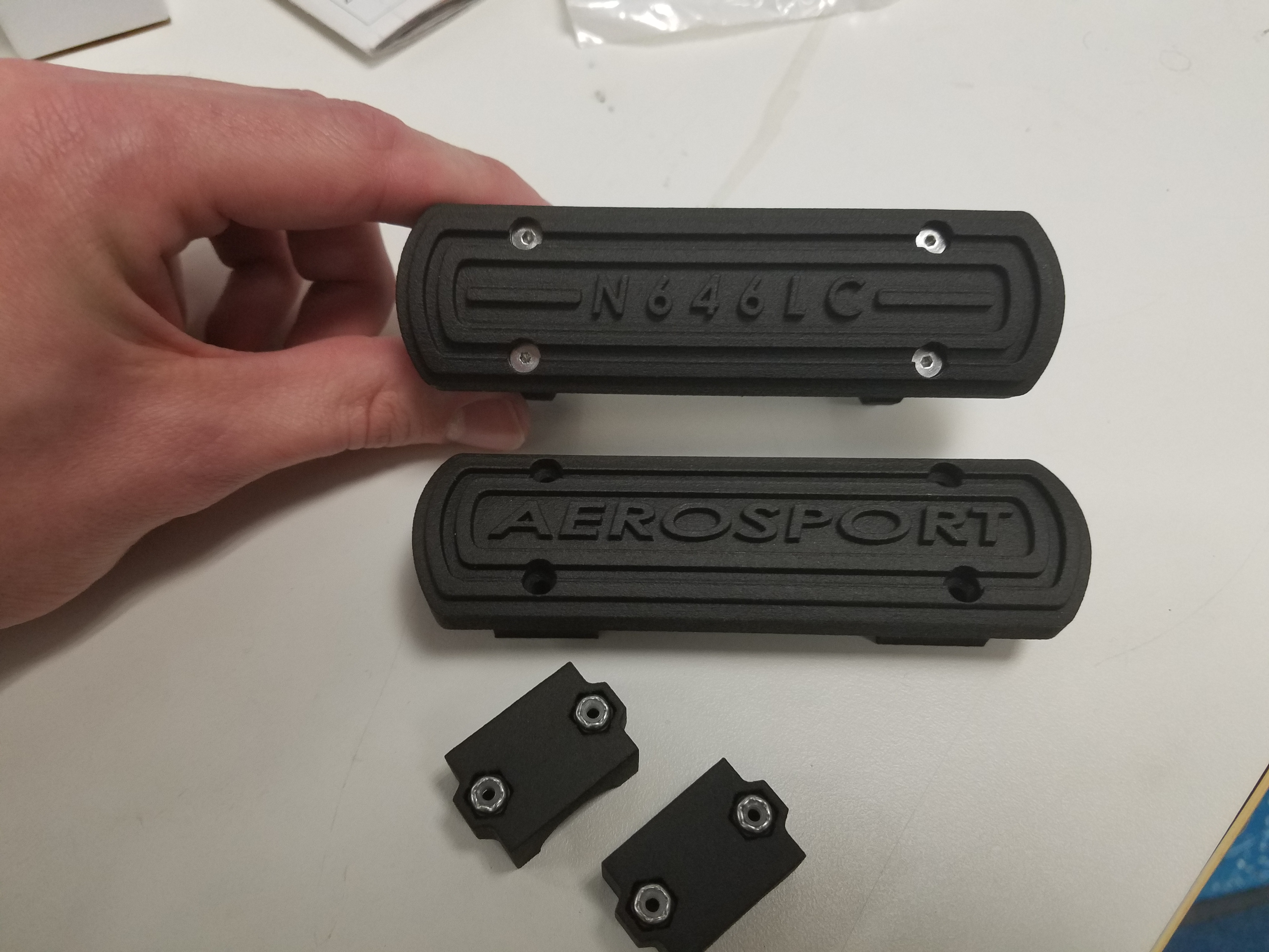

While on the discussion of rudder pedals, Aerosport Products is going to
start offering these extensions with Your Custom N-Number or whatever you
would like,
Or just a standard set with the AEROSPORT on them. These will be Nylon PA12
and the cost will be $75.00 per set of 2 for the Standard and for custom
will be
$95.00. For custom pedals allow around 2 weeks. I have been flying with a
set of these that I machined out of Aluminum for 8 years. I have just
changed over to the new ones.
You will need 2 sets for pilot and copilot

> I painted my Vans pedals (the pads with the holes)  in silver and
> they really look spiffy - like stainless.  Didn't see that coming.
> Those aftermarkets look pretty spiffy as well.
