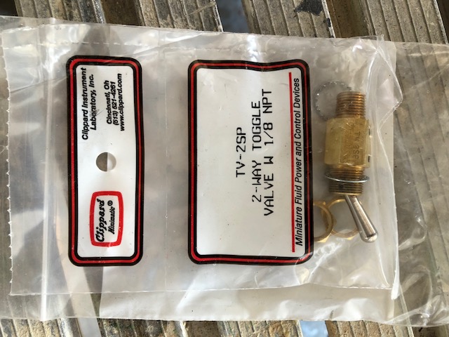

Gidday,
Regarding alternate Pitot Static sources, here is my panel switch pictured below. If like me you get the journaled version, the details are
TV-2SP
2- WAY TOGGLE VALVE W 1/8 NPT
by
Clippard Instrument Laboratory
Miniature Fluid Power and Control Devices
Hope this helps.
Tony Renshaw
Lost in the Wilderness, again.

Hi guys, I just recently installed an aftermarket voltage regulator replacin
g the Ducati on my 914. Its a John Deere unit that the RV12 folks are using
with good success. The part number is AKH6004. I found it online for $20.
23 with free shipping. The unit has a set point on 14.2 volts. I ordered a
second one to keep in the plane as a spare. At that price it was too hard n
ot to. While not exactly plug & play, it only required a sub plate to reta
in the existing mounting holes. See picture attached.

Here is the photo
