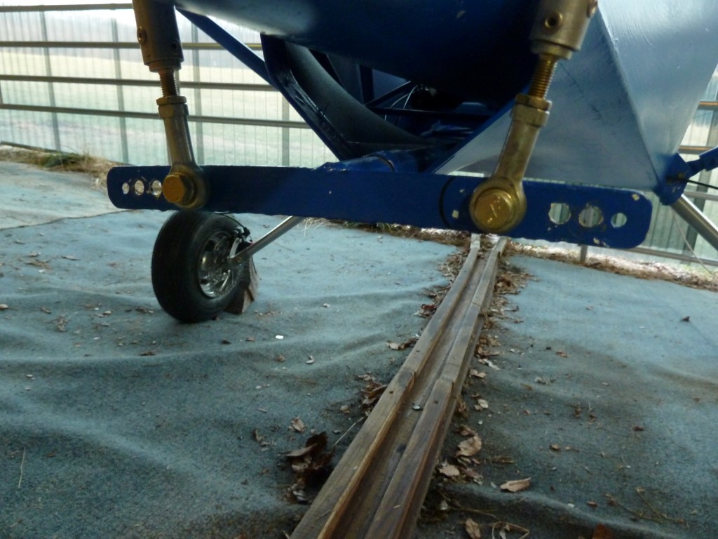

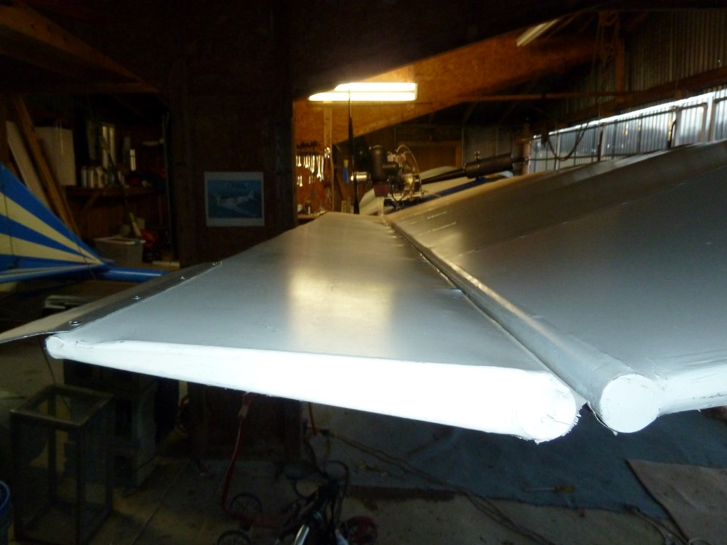

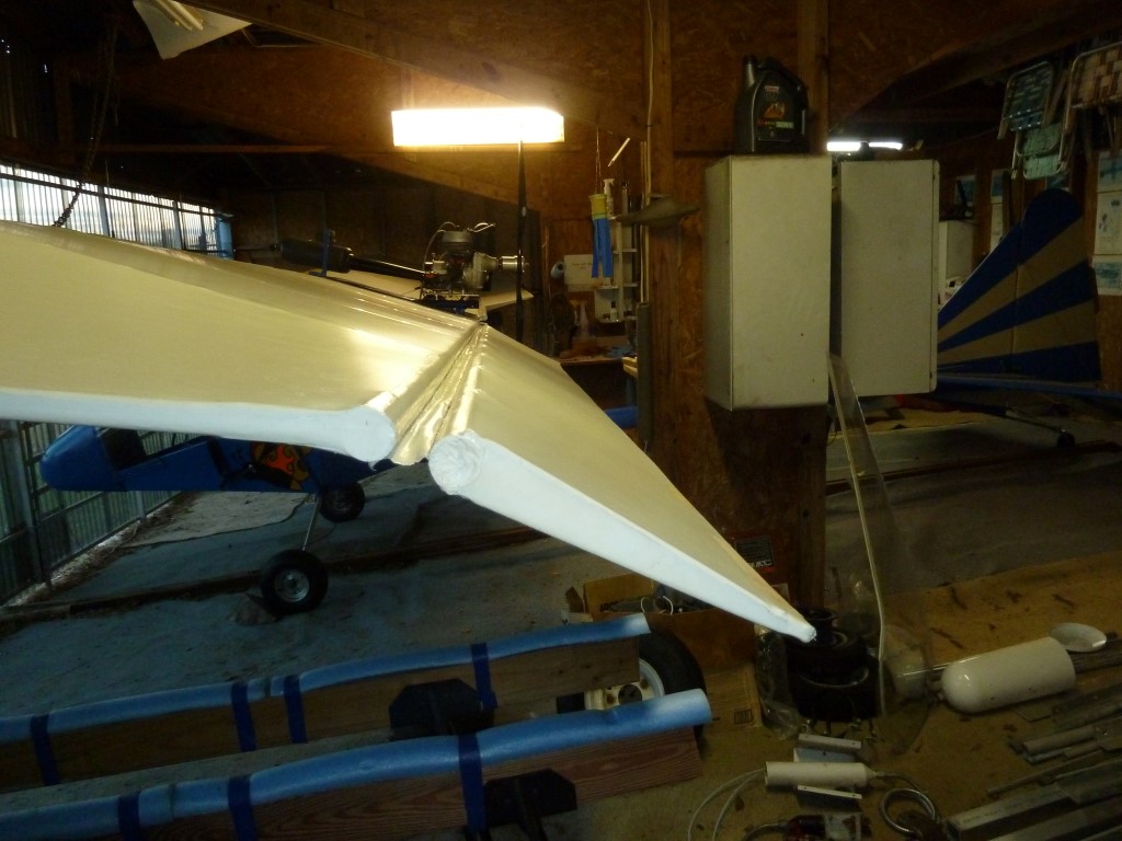

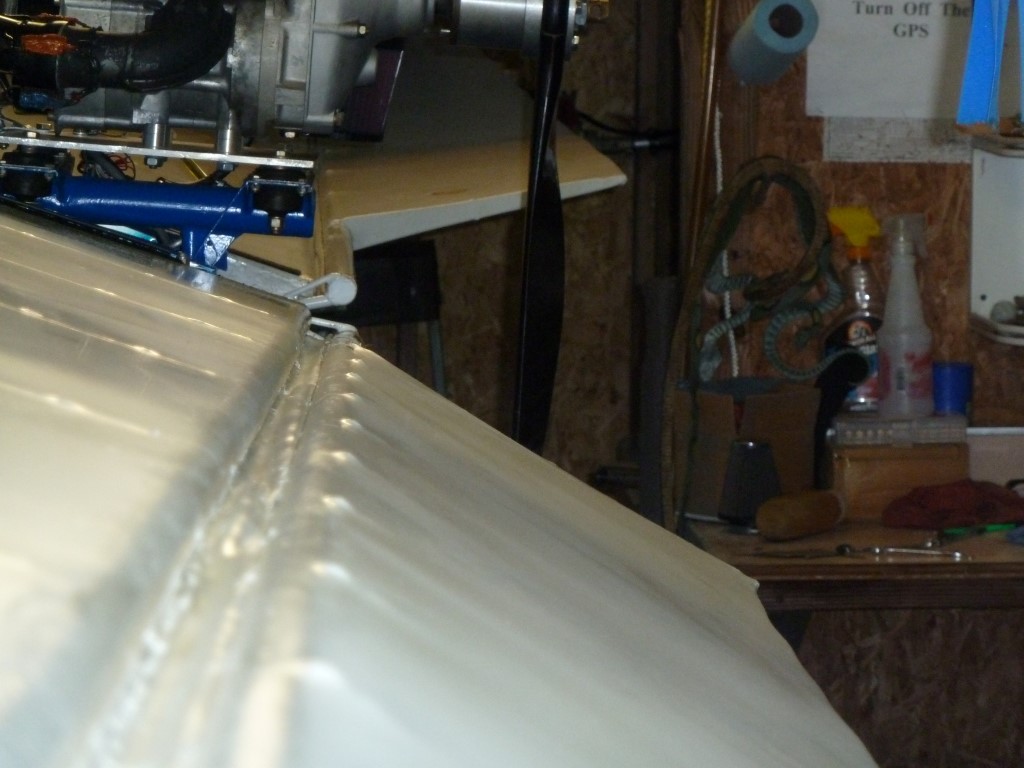

As most of you long time listers know, I have long been an advocate of reducing Kolb aileron deflection for a more pleasant flying experience, because in their stock form, Kolbs have a LOT of aileron deflection. Did it many years ago on my MKIII, which I documented here: http://oh2fly.net/oldpoops/pg7.htm
This afternoon was an excellent day for flying, 60 degrees and no wind, so I went one richer on the main jet from last week and went flying. Still not quite perfect, but a lot less pipiness than before. Now instead of a 700 rpm range of foolishness, we only have a 300 rpm range where the 277 doesn't want to stay put. Still thinking that after it gets fully broken in it might settle down.
Then Dave & I modified the aileron bellcrank, moved the pushrods in as far as practical, readjusted their length and flew it again. WOW! Talk about light on the controls - she is now a dancer! At higher speeds, you can see and feel the ailerons twisting to less than full throw, yet it cranks and banks just like it did before. (And why wouldn't it? Air loads limit maximum deflection; so no matter how much throw you build in with your bellcrank moment arms/lengths, the ailerons are still only going to deflect just so far.)
At lower speeds, the aileron tubes quit their torque twisting, you get full throw of aileron deflection, excellent response, and in both cases, the amount of pressure involved at the stick is MUCH less than before.
Bear in mind that this is just one flight, and not a couple hours of both Dave & I wringing it out and taking notes, but initial results are extremely positive. And, as always, we can easily put it back like it was.
Note in the pictures that you can see how far the lower lever point has been moved in from stock, (out at the end) and also the amount of aileron travel still available after the mod. Substantial.

The first Fire Fly's had enormous ailerons. Homer designed for his style of
flying, tree top level, in contact with the birds in the trees, extremely
low and slow. For that style flying they were ok. Anything over a crawl
would lock them up based on their sheer mass/area. On later model Fire
Fly's the aileron cord was reduced quite a bit.
I never flew the early models with the long cord ailerons, but got a lot of
time in the later models. I don't recall heavy ailerons on the Fire Fly's I
flew. In fact, on one cross wind landing at Lakeland, I hit the stop, ran
out of aileron. Based on that experience, I wouldn't want to shorten the
cord on the later model Fire Flies.
On Richard P's Fire Fly, just eye balling, the aileron cord looks like the
original.
Based on my flight experience in the prototype MKIII, I cut the ailerons on
my MKIII a good bit. Don't remember the dimensions now after 27 years, but
I have never run out of aileron. Even after reducing the cord on the
ailerons, after 60-65 MPOH they start loading up. Fine with me. I'm not
looking for snappy roll at those speeds. No problem going lock to lock
below 60.

I'm a long time flyer of a MKIIIC. I have gotten used to the heavy ailerons. Here are a few thoughts that haven't be discussed. At slow speeds near the ground you need all the control you can get hold of. I used to have a narrow strip cut out of my woods. On more than one occasion I hit the stops on my stock ailerons and once I hit the stops both ways. My Kolb doesn't have a neck snapping roll rate but when I'm slow and near the ground and an unexpected wind gust hits it is nice to know I can keep my wing tips from hitting the ground. When at cruise speeds my ailerons are heavy and keep me from over stressing the wing.
I will never make that change to my airplane.

Good on ya Rick, I respect how you configure your airplane. Each of us has to do as we think best.
OTOH, because of the way that high speed airflow loads up the ailerons, (and I have not compared the aileron tube diameter/wall thickness of the MKIII ailerons with the FF/Original FS) nothing you change or leave alone in the specific area under discussion will cause the ailerons to deflect enough to overstress the wing. The aileron tube will twist under applied force as airspeed goes up, and maximum aileron deflection relative to stick throw decreases as a function of increased airspeed.
Which was one of my premises: at high speeds the ailerons are not going to move much anyway regardless of how much the bellcrank is trying to move them. And yes; at low speeds the ailerons with the stock setup will move more, and if you think you need that, by all means keep it.
It would be interesting to mount a video camera on the rear cage below the trailing edge looking toward the wing tip to be able to show actual aileron deflection at full throw at different airspeeds.
