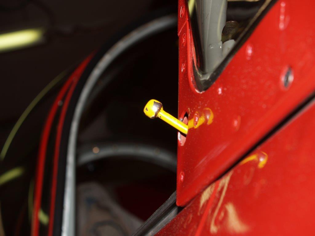

I took a 10 / 32 structural screw slipped some washer the
soldered / brazed them together, chucked it in the drill press
using a file made a ball shaped nob . Be working well for 16 years.
Picture attached
