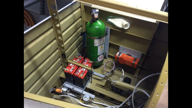

I’m sure I've got some better photos on my laptop, but this is the best I’ve got on my phone from way back when....
Basically used opposing aluminum angle riveted to the flat side of the stringer. A .063 plate riveted to those. Couple of large lightening holes in it to remove weight. Then the clamps attached to the plate.
Has stayed quite well. You have to be careful to install he bottle with an air gap between the bottom stringers, so you’re no let running the strikers and bottle together on the bottom.
My fill port is also on the bulkhead just above the baggage door. So you can open the door, kneel down and look up, and find the fill port/gauge.
If you need better photos, let me know. Mine is opened up at the minute and hope to close it back up in the next day or two.

PostPosted: Thu Feb 08, 2018 4:07 pm    Post subject: O2 Bottle Mounting Reply with quote
No aft CG issues with mine. And I have two pc-680’s back there. Bottle is carbon fiber though...
I do plan to replace the 680’s with EarthX batteries next time just to provide a bit of CG relief.
But on the numbers now, I don’t have any issues going out aft....... /w D4A5 and MT on the front end.
