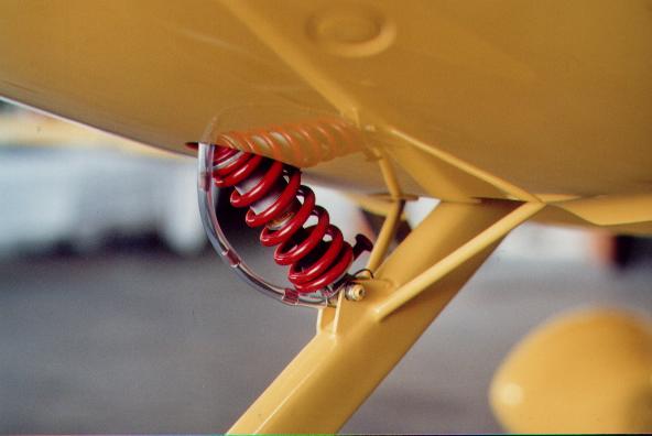

However, I did incorporate some modifications while building which may have helped preserve my nose gear. I’m talking about the XP. Later models may differ. I have the larger wheels too, and the larger nose wheel. The original plastic wheel was not used as it was significantly out of true. An aluminium AZUSA wheel was substituted. I did my best to balance this too, with the tyre on of course.
I made bronze bushes to press fit into the aluminium support brackets that are glassed to the firewall. These provide a much better bearing for the bolts securing the noseleg. I also substituted a mountain bike shock system, to replace the original spring assembly. Used a RockShok, with a hydraulic damper, and a spring rated at 200 lbs. This fitted very nicely on the original mounts. That spring is a deal softer than the original, and the damper goes a long way to absorbing shock loads.

I sold my Pulsar a few months ago, and the handbook for the RockShox went with it. If I remember correctly it was a RockShox deluxe, 7 1/2 inches centre to centre, with a 200 lb spring. I bought this in 1998. They might be hard to find now, as fashions change quickly in that market, but very likely there are very similar items available.
Brian
Just like this one: http://www.bikerecyclery.com/nos-vintage-rockshox-deluxe-rear-coil-shock-rebound-adjustment-red-spring-7-5-x-2-0/
Photo installed here . .
[img]cid:73A8D835-37BE-423E-81C1-F66C6D22CB76[/img]
