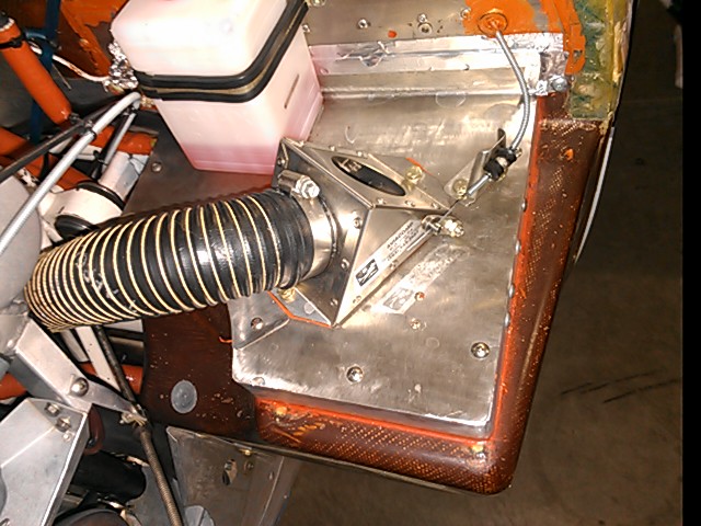

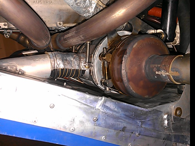

PostPosted: Wed Feb 07, 2018 11:39 am    Post subject: Europa Cabin heater. Reply with quote
Sure, using a Sky-Tek heat muff and Aviacomp DL-025 cabin heat box.
