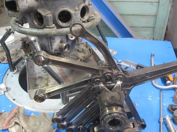

PostPosted: Fri Feb 09, 2018 4:02 am    Post subject: Bent connecting rod Reply with quote
For those unfamiliar with hydraulic lock, this is a bent connecting rod from a M14P. The engine will continue to run like this for a while, but inevitably the rod will break and trash the engine.
