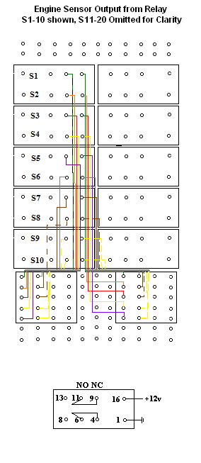

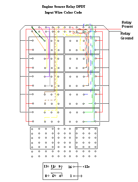

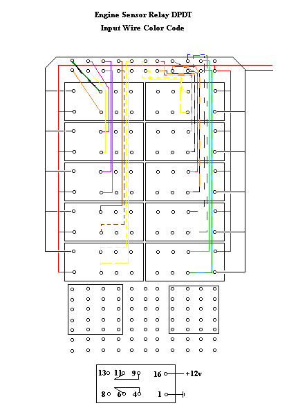

Not to beat a dead horse. But here is a bit of data on what I did for backups:
I installed a Dynon Eng Management System as a backup and made a relay to switch on Brown’s plane, and a complete set of 2 ¼ for 419PL with a second set of sensors.
Relay board details are shown as attachments above.
419PL was interesting as it was analog:
Tach was off of the ignition lead with a simple switch to the Blue Mountain or UMA guage.
Manifold pressure was split off a Tee.
Oil Pressure was off a Tee with two pressure sensors on the Pax footwell.
Oil Temp was off the Rotax oil temp and the other was installed in the return line to the tank.
Cylinder temp just had one on the #2 and the other on the #3 cylinder sensors.
Volts and Amps combined gauge off a separate shunt.
Fuel Pressure was off a Tee.
It took too much room for a complete set of gauges so an enlarged panel was built.
The extra Dynon or EIS with a relay made for panel space but time making the relay.
