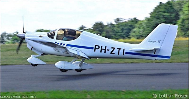

I have one of these LED strobes https://www.thiesen-electronics.com/en/products/annex2 mounted on top of the fuselage behind the cockpit and can recommend it. Notice, that they don't have a seperate control body - it's just the strobe to mount on the fuselage.
