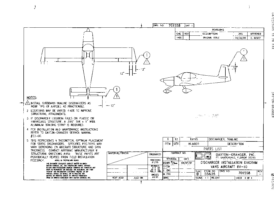

I used to have Archer antennas in each wing tip, one for each radio. After loosing the glide slope signal several times during the turn to final, I decided to add a cat wisker antenna on the belly, which cured the issue. The Archer antenna is directional, and while it performed just fine for VOR reception, it was not as solid as I would like it for the ILS approaches.
IRT static wicks. I installed mine from day 1 and I have never had any P-static issues. I have heard now of three instances of airframe static on the RV-10, which was cured with the installation of static wicks. If you do a search on VAF you should be able to find the posts.
You won't find a production certified IFR aircraft without them, and if you are serious about flying IMC, then IMHO they should be installed. Dayton-Grainger has a drawing with recommended locations for the RV-10, posted below.
| Description: |
| Filesize: |
194 KB |
| Viewed: |
33173 Time(s) |

parish(at)parishmoffitt.c Guest
Posted: Thu Jan 18, 2018 12:10 pm Post subject: VOR/GS/LOC Antenna and Static Wicks |
To echo Tim, and add on a little here. I think one must realistically look at their abilities and their mission profile for the airplane. Not only is there a difference between VFR and IFR but there is a difference between IFR and IFR to 200 and a half on both ends where the total time for the flight is the amount you put in your logbook as actual IFR. I tell people all the time I am building my airplane to practically CAT II standards as I shoot approaches to 600ft RVR on a regular basis and feel comfortable doing so. Someone who flies through a 2000 ft overcast layer a few times a year might not have the same comfort level. I think you also need to look at where you live as well. Do you live in AZ, then a less capable IFR setup is not that big of a deal. Do you live in Seattle? Can we install auto land in this thing, LOL? I live in the Carolinas and know we can get socked in from time to time for 2 or 3 days straight.
To add one more point for the original poster and this goes to the VOR antennae discussion. Where do you plan to fly your airplane? If you plan to do any flying outside the USA and in particular to some of the remote Caribbean locations, having a good VOR antennae is paramount as that may be your only means of listening to flight service. Also some airports here in the states still use VORs to transmit the ATIS, Scranton PA for instance. I used to love it when I was flying at the regional airline and watching my FO try to figure out how to get the com radio to go to 108 or 110 point something.
My airplane will have a whisker up top. I placed a doubler plate on the top rib and installed nut plates for the RAMI ant.
http://www.aircraftspruce.com/catalog/avpages/ramiav525.php?recfer=11262
I have also installed the static wicks per Mouser/ Dayton Grangers instructions. I have chosen to reduce my cost a little and gone with non-cert wicks at 26$ each rather than 47$. Just don't forget the bonding straps between the control surfaces and the fixed surfaces.
http://www.aircraftspruce.com/catalog/elpages/esd3staticwick.php?clickkey=6974
http://mouser.org/projects/rv-10/staticwicks.html

Your GS issue is the same issue I had with the archer antennas. So I replaced them with a tail mounted dipole (cat whisker). Problem solved!
The archer antennas worked great for VOR and LOC reception, just not the GS, which is not surprising since the GS frequency is in an entirely different band (330mhz) for which the antenna is not matched. Resulting signal strength is low and coupled with the directivity caused by the airframe and antenna mounting location, does not make it an ideal candidate for a GS antenna.
The issue you had with P-static I also experienced, but not on the -10, on a slow 130kt Piper Archer. Total comm failure in IMC. I installed wicks on the archer and never had the issue again. It's interesting to note that the Piper had a storm scope installed and that prior to installing the static wicks I would see numerous false targets. After the wicks the false targets disappeared. It was fortuitous that Piper actually had an option for the wicks, so it was easy to add them on.
As far as the -10 is concerned, I built it knowing I would install wicks. I fly in IMC quite often and have never had static issues.
