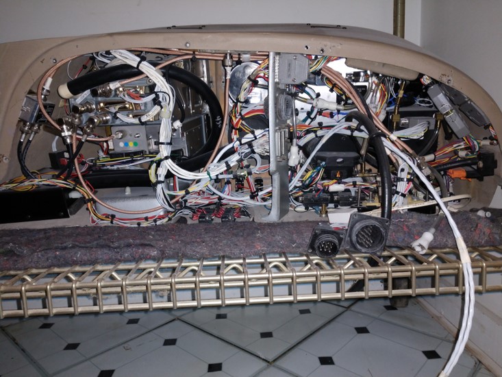

I have been mulling this over and am thinking that I need to rebuild the panel - taking my time as opposed to rushing to get in the air.  I will
 - tidy up my electrical installation using  blade fuzes instead of bulky and heavy CBs - this will free up a lot of space in the panel and reduce weight
 - include a second 7" dynon and adahrs
-  and while Ive got the panel off include the sensor wires that I should have included to start with.
Things happen for a reason.
Will

yes I have airspeed and rpm in round instruments. I figure I can get alt from my GPS
However I have grown rather addicted to the synthetic vision and autopilot and it is a bit disconcerting when it goes blank. I can imagine that it would be a tad more disconcerting if one were in IFR....Im very glad it happened now and not half way between Curacao and the Dom Rep....
Will

Will,
I installed my first Dynon some 10 years ago and stayed away from the Skyview until they got the bugs out. Early Skyviews at the air shows were so hot you couldn’t keep your hand on the back of it (over 120 for me) and the D180 LED front plate got very hot also. They were also like the early Blue Mountain: If you push the buttons fast and often, it will hang up just when you need it most. Software glitches also abound in all these computers. Good news is all the manufacturers allow you to download your error file and send it to the factory tech reps. Typically some sort of RMA or patch has to be made as one piece of equipment talking to the PFD will cause an error forcing the PFD to hang up. Best advise until you get everything sorted out: Fly in VFR and REBOOT! I still fly with a Blue Mountain Gen 4. I have backup round dials, mag compass and a handheld. I’m the department of redundant redundancy. The Gen 4 has never failed, but it is 8 years old now, so its life is limited as with all electronics.
We in the experimental community can install many variations of equipment. Certified cannot. If you have been following news, Dynon is getting certified for a number of aircraft, and equipment do’s and don’ts are following.
Regarding Cooling of Avionics Only:
The D100, D180 and early Skyview have always had cooling issues. The only solution here in Florida was a cockpit air fan blown over the instrument which at the time had no air inlet as on a GRT.  I worked on cooling flow until the inside the panel and internal temperature monitors installed in other equipment showed temps that were well within their limitations and an extra OAT put into the panel or use my remote thermocouple on my VTVM. My cockpit ventilation was always good so drawing outside air to the panel was not necessary.
The new Skyview CPU runs much cooler and has twin fans so here in Florida in many LSA aircraft, they are generally free of problems provided the panel does not exceed 120 F, and the fan inlets are clear with good heat exit out the top of the panel. Above 120 F in the panel, they seem to blank out or shut down. GRT has an internal temperature reading and I believe the Skyview has one also, as well as warning flags. The problem with the smaller Dynons (D10,100,180) is the screen goes blank but the unit can still be working, which is kind of dumb. No warning, they just used to shut down. That has been cleared up on the new Skyview...
Normally outside air is not required to be funneled into the panel, but if your Europa panel is tight, and there are other hot running instruments installed, you may find a cooling fan and the tubes to be a reasonable investment. You should also look at cooling exit from the panel as any air coming in has to get the hot air out.
There are many ways to do this, from simple 25-40 mm cooling fans normally used in a computer, to regular aircraft fan and tubing systems shown in Aircraft Spruce. I’m used to panels where I’m putting 5 pounds of crap in a three pound bag. As you can see in the example below, there is a three hole Ameriking fan sucking from the passenger side footwell, with tubes going to the Garmin 430, one horizontally to the Dynon FD 180, another going to an EXP electronic buss under the radios covered in a custom box. Note there are two fans in the top of the panel to exit the air out of the panel. This keeps the panel internal temperature on the bench to exactly the ambient room temp with everything running.
Best Regards and keep testing to get all the bugs out,
Bud Yerly
