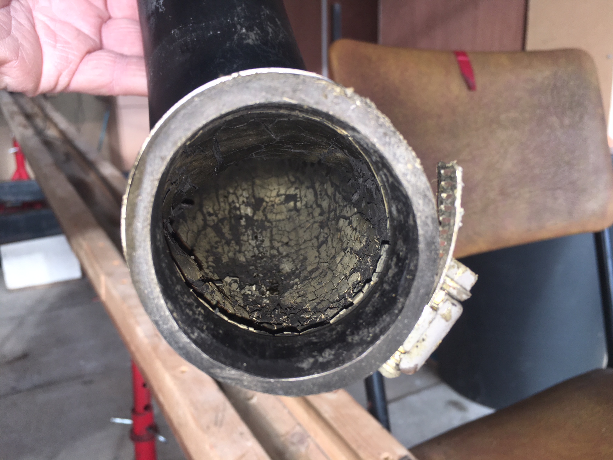

Tim,
On inspecting the XS refuelling fuel pipe on G-CBHI today it was found US. Therefore, please add me to the list if it is suitable for the XS? Clearly the XS is a much shorter pipe than that required for the Classic. The current LAA Standard Mod does not cover the XS aircraft but Brian has indicated your pipe will suitable for both and will be the basis of the new XS LAA Standard Mod. From your previous work on this mod do you know if the same specification of pipe has been used anywhere else on the Europa? Did you find any positive way of flushing out any debris from the tank? I have not tried yet.

Hi! Roland,
Happy New Year .
No the main concern has been about Classic fillers located in the top of the
roof (long pipe) down to the tank. Although the failure Shown was between
the Cobra filling moulding and the tank.
Tim Wards Bent metal pipe is for between the Cobra and the tank.
The purpose of the metal piece was to reduce the smell of fuel ( obviously
in those days from absorbent rubber, especially being such a long pipe.
Bob Harrison. G-PTAG Classic Wings XS Cockpit Moulding .
