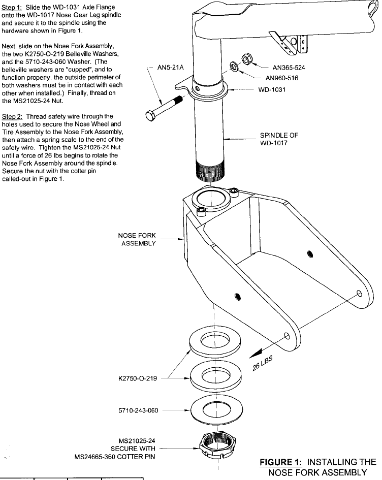

Well, mine has gotten noticeable enough to do something about. Of course I reviewed my archives and Tim's website as refresher.Taking the cowling off and checking things I found that I could not tighten the big nut to the next flat, so the amount of pull is irrelevant at the moment.
Has anyone tried new Belleville washers?
Secondly, I noticed about a 1/4" of up/down play on the nose gear leg, which I assume is compression of the donuts. (I am at about 130 hours).
Will check today to see if another washer is needed. Yes, I have done the service bulletin upgrade, and there was no play at the time.
I guess the next step will be to get a wheel balancer and balance the nose wheel. Then do the mains at annual condition inspection.
Has anyone drilled the bottom of the gear leg to get an intermediate cotter pin position for the pivot nut?-sent from the I-droid implanted in my forearm

I have 2 holes in my gear leg to provide for a little more
adjustment precision. No big deal on that.
Are you 100% sure that the shimmy is nosewheel? I really doubt
it is. Almost everyone who has a shimmy, has it in the
mains, although it FEELS like a nosewheel shimmy. I really
don't find much for issue with the nosewheel at all, other
than making sure you have a good breakout force on the
rotation. And, of course, there is that need to take out the
play of the donuts occasionally. I can't remember how many
I have in there, but at least 2.

I had the same 1/4” vertical play and found the bushing to be the culprit. A little bit of play in that bushing easily makes a 1/4” out at the wheel.
Vans sells over sized bushings, so I purchased one and found to was too over sized.
My cousin is a machinist, so be sent me a set of snap gauges and I measured it. Then we turned the oversized bushing down to match the hole with .002” gap.
It’s currently sitting in the center console of my truck so I don’t have a report yet. Hopefully in the next few weeks I can have it installed and see if they addressed the play.

Yes, I have suggested that everyone drill a 2nd hole 30 degrees off from the first hole. This will give you the ability to make the correct adjustment without leaving it too loose or too tight.

Thanks Tim. Yes, I had 3 friends observe my taxi in from last flight and comment on how much the nose wheel was shimmying.Yes, I have had main gear shimmy in the past. Nose is at lower speed and higher frequency shimmy.
I'll check with the fish scale, get somewhere around 25-30 lb pull and then drill new hole.

Interesting. This is the first time I can actually remember anyone
actually having the shimmy be nosewheel related. I guess I'd
do a tire balance then. And while you have it on the balancer,
make sure it's still round perhaps.

I know nosewheel shimmy is common on the two place RV's as AntiSplat
Aero offers a machining to replace wheel bearings with sealed, precision
bearings, Shaving of tread to ensure tire roundness and then spin balancing.
Obviously our design is a bit different with the donuts.
Will try the obvious things and see if that gets rid of it. I think it
was Les commented that his went away after balancing all three wheels.
Hard to tell how much shimmy might transfer between the gear legs.

As Kelley noted, I used a motorcycle wheel balanced on all three wheels. It worked quite well. Of Kate I have noticed that I am getting a shimmy again. WheN I last had my pants off (wheel!!!) I noticed a lot of crud on the wheels. I wonder if that has caused an imbalance.
Anyway, I will be doing my annual after Christmas and plan to replace my main tyres and rebalance everything along with setting nosewheel breakout pressure. I’ll report back after I do this - this will be in lat Jan as I will be away till then.

At around 300 hours I noticed that my nosewheel tire was way out of round. It was still the crappy AeroClassic tire that came from Van’s. It wasn’t worn, but it was deformed. Something to check.

For someone who is still building, and never heard of this, can you tell me where is that 2nd hole to be drilled?
Or better, a picture of that

The first hole will be lined up on one of the spaces on the nut. Mark on the tubing where it currently lines up, and mark where it lines up on the next space. Then loosen or tighten the nut half way between those two marks. The drill through the near side. Then drill the far side from the other side, making sure you're 180 degrees.If you have a punch and a center drill, do that first on both sides, then remove the nut and use the drill to finish.

You assemble that setup and then drill a hole through the threated part of WD-1017 to secure the nut with the cotter pin just drill another one 30 deg to that one onto the tighter side
[img]cid:part1.3691CB79.E662623B(at)gmx.net[/img]

30 degrees from the original hole.

Ah ok, thank you all
