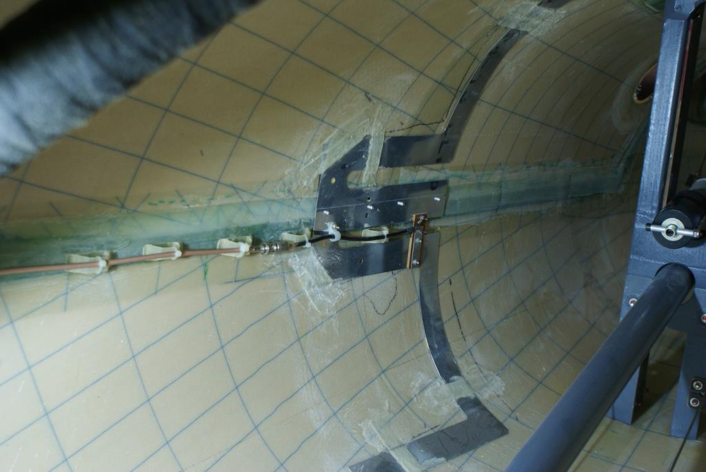

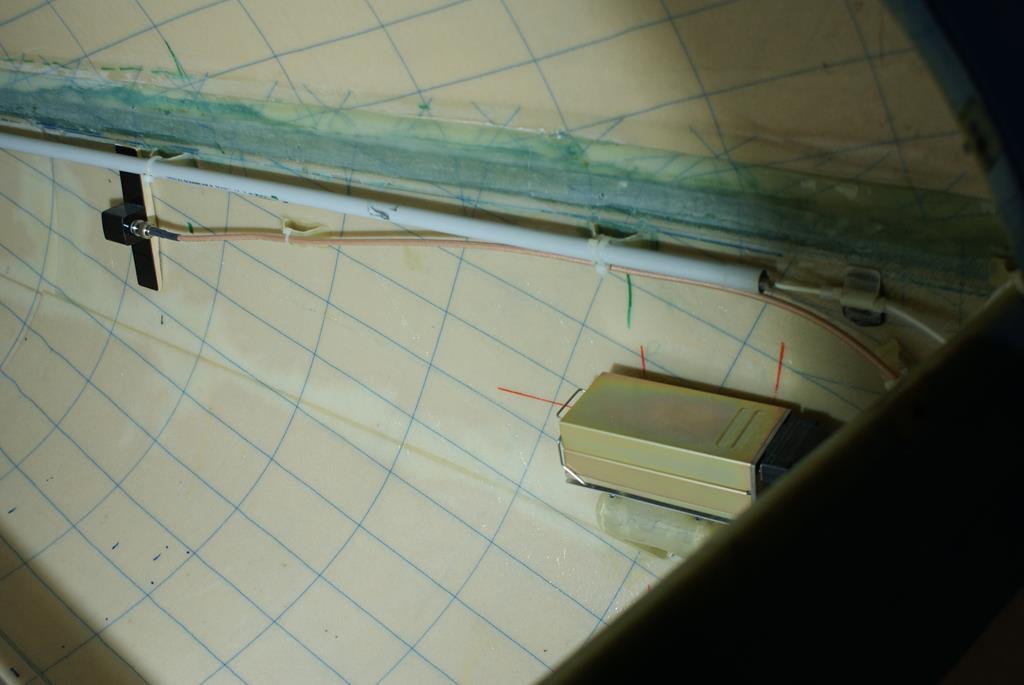

PostPosted: Fri Dec 29, 2017 8:46 am    Post subject: Transponder Ground Plane Reply with quote
An other solution is a dipole antenna inside the fuselage.
There is no Ground Plane with this kind of antenna and nothing outside
the fuselage.
Available from Spruce. Part #: 11-04212.
See:http://www.aircraftspruce.com/catalog/avpages/antennasystems1.php
See the attached pictures about the installation inside my Classic with
the TRIG TT21 main unit
close to the antenna. The same installation has been made with the radio.
These installations has been passed all the checks and work fine.
Best regards, Ruedi

tennant
Joined: 19 Apr 2011
Posts: 121
PostPosted: Fri Dec 29, 2017 11:33 am    Post subject: Re: Transponder Ground Plane Reply with quote
Hi Ruedi,
I thought that you had secretly photographed inside my fuselage!!
My Setup is absolutely identical and has been working perfectly for 20 years. I can only recommend it.
Best regards and HAPPY NEW YEAR
Barry Tennant

PostPosted: Fri Dec 29, 2017 12:02 pm    Post subject: Transponder Ground Plane Reply with quote
Ruedi,
Can you confirm the precise dimensions of the small alloy plate covering the tufnol of the comms antenna please, and the thickness of the tufnol.
Rgds.,
Duncan McF.
