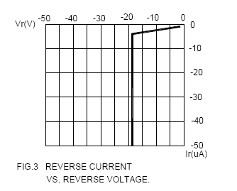

Here's an exemplar set of plots on a bright, white LED.
http://tinyurl.com/q4f25xe
[img]cid:.0[/img]
For a diode rated at 30 mA, one selects a resistor that
produces no more than 30 mA at maximum expected system
voltage (call it 15v). In the curve above we see that
voltage drop is 3.4V at 30 mA. (15-3.4)/.030 = 386
ohms. So the resistor to choose is no smaller than
this calculated value to stay below the diode's rated
maximum operating current.

Reverse voltage is another mater. Note that around
18volts, the current takes a sharp spike toward
very high . . . read damaged junction.

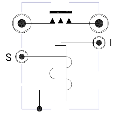

For your review, here is an attachment of my solution. My engine/starter is in a state of storage so the LED based circuit cannot be tested yet. I chickened out and replaced the diode with a mini bulb. Seemed like the simplest way in my case.
Can you articulate the source of your 'fear?'
I thought that the explanations and experiences
shared here on the List would have assuaged your
concerns. By all means, use the LED without protection . . .
and simply watch it for failure. It's a no-risk
event easily spotted throughout its lifetime on
the airplane.

The wiring suggested in S702wire.jpg might make more
sense if you saw the schematic . . .
Actually, the "I" terminal is just fine . . . that's a THIRD
stationary contact within the S702-1 contactor that duplicates
the connections between the two FAT terminals thusly . . .
[img]cid:.0[/img]
