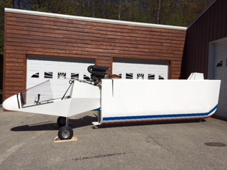

I have owned two Kolb aircraft, a Firestar and a Kolbra. I flew the Firestar for 30 years and would still be flying it had I not sold it. I stored it in my garage during this time and trailered it to a local private field. I folded and unfolded the wings and tail everytime I flew. The folding u-joints are steel and will not wear. The amount of wear is negligible, however, I kept the joints greased. The u-joint bolt can be replaced and I replaced it once and didn't really have to. I think it had about 350 wing folds over that time. One thing to be careful of is the wings are extremely vulnerable near the ground when trailering because the leading edge is close to the ground. I always set up the Firestar alone without any help. Once the wings were unhitched, I would get under and lift the wing on my back to pin the lift strut in. It can be done as I did it all those years. It takes about 20 minutes to set up, but many times I would get interrupted by someone asking questions, so it would take onger. The Kolbra wings can fold, but I store it in a hangar and never fold them. I have taken the wings off when I replaced the engine.
It's a little bit of work setting up the Firestar, but that is the price I paid for free hangar rent at home. One advantage of having your plane at home is that I could work on it easier with all the tools there. I also liked having it close by because it was my baby and nobody is going to steal it or anything off of it from my garage. Smile

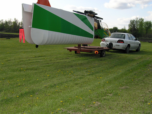

Kolbs do just fine trailering on main gear.

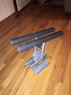

It is recommended to fabricate a pedestal to carry the tail boom and take the load off the tail wheel and tail wheel strut.

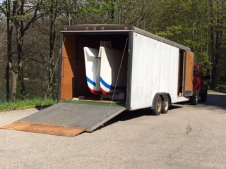

Long distance trailering I removed the wings and secured in cradles on each wall of the trailer.
An enclosed trailer is best for long distances and highway speeds.
Open trailer for local traveling to and from airstrip.
It is hard on the aircraft to tow at highway speeds on an open trailer.
I've towed my Ultrastar, Firestar, and MKIII on the main gear with the tail wheel assembly attached to my tractor. It is 3 miles from my home to my grass strip. I did this with wings removed. Wouldn't want to do that every time I flew. Always scared to death some idiot was going to run over my airplane on the highway. Always a nail biter.
Homer Kolb designed folding wings on the Ultrastar and each model thereafter. It was always a big selling point.
I don't fold unless I have to bring the airplane home to work on it. Haven't had to do that in many years. Instead of clevis pins I use AN bolts and nuts to attach wings and flying surfaces. All fittings have welded bushings. No slop in attachments.

I have owned two Kolb aircraft, a Firestar and a Kolbra. I flew the Firestar for 30 years and would still be flying it had I not sold it. I stored it in my garage during this time and trailered it to a local private field. I folded and unfolded the wings and tail everytime I flew. The folding u-joints are steel and will not wear. The amount of wear is negligible, however, I kept the joints greased. The u-joint bolt can be replaced and I replaced it once and didn't really have to. I think it had about 350 wing folds over that time. One thing to be careful of is the wings are extremely vulnerable near the ground when trailering because the leading edge is close to the ground. I always set up the Firestar alone without any help. Once the wings were unhitched, I would get under and lift the wing on my back to pin the lift strut in. It can be done as I did it all those years. It takes about 20 minutes to set up, but many times I would get interrupted by someone asking questions, !

The Kolbra is a larger tandem model of the Firestar that accepts larger engines similar to the Rotax 912's. I bought mine ready to fly from a friend.
The Firestar trailer is one of these trailers that can be bought at Home Depot covered with a sheet of plywood. It measures 8'x4' and can be towed with a car. It will tow at highway speeds, but I only had to trailer it short distances. I wouldn't recommend towing on this type of trailer long distances.

On the other end spectrum. This is the trailer I use for my original Firestar. I’ve use it to move my airplane from California to northern Michigan. The Firestar was stored folded in it for some 28 years. I hanger it now. It’s nice not to have to fold the tail & wings every time I want to go flying. I consider it a luxury. Kolbs are easily folded. Its just 20 minutes that I’d rather send flying.
I use a scissors jack type boom tube pedestal, leading edge pads and it rides on the main wheels.
I lock the wings together when folded to keep them from bumping into the fuselage. I’ve found that if your going nick up your paint, it will be during loading and unloading. Plenty of tie down straps are also highly recommended. For really long trips I remove the wings and put them in wing racks on the sides of the trailer mounted inside. I hope these pictures aren’t to big for the site. Blue Skies, everyone.
