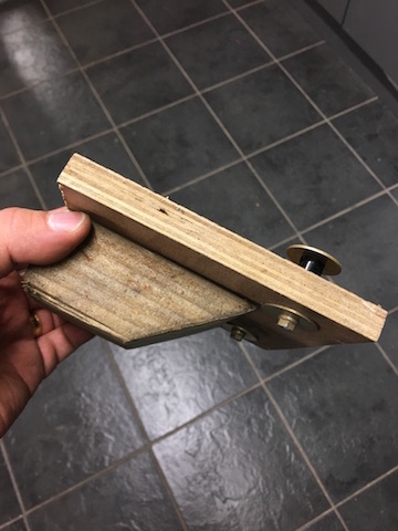

PostPosted: Wed Nov 22, 2017 1:04 am    Post subject: Tool kit and spares kit Reply with quote
Frank, If you are travelling to anywhere remote and it is a mono, then apart from a spare inner tube, you should give some thought as to how you might jack up the plane to get the wheel off. There is an account in the Europa Flyer about a year ago of Tim Houlihan having to abandon his plane on one of the Arran Islands in W Ireland. We rescued him a week or so later having constructed a triangular pad with two prongs which locates on the U/C arm to give a hard horizontal surface that you can put any sort of car jack under. Trikes are no problem - you can simply lift the wing on the puncture side and put any sort of trestle or prop under it to hold it up.
Regards, David Joyce, GXSDJ

PostPosted: Wed Nov 22, 2017 11:03 am    Post subject: Re: Tool kit and spares kit Reply with quote
Hi David. Yes I have built a mono and yes I have come across the article in the flyer magazine explaining how to construct the simple wooden adapter which I will make in a week or two.
spcialeffects
Joined: 29 Aug 2012
Posts: 306
Location: Kent
PostPosted: Thu Nov 23, 2017 10:05 am    Post subject: Re: Tool kit and spares kit Reply with quote
Here's what i did in an hour and a half. Essential piece off kit I agree

Frank,
We have carried these items and never been stuck. Mostly we try to have items that are unique to our airplane - you can usually borrow other tools and parts.
Strap to attach to engine frame to lift aircraft to change tire

Spare inner tube (it is difficult to find a tube with the bent valve stem)
