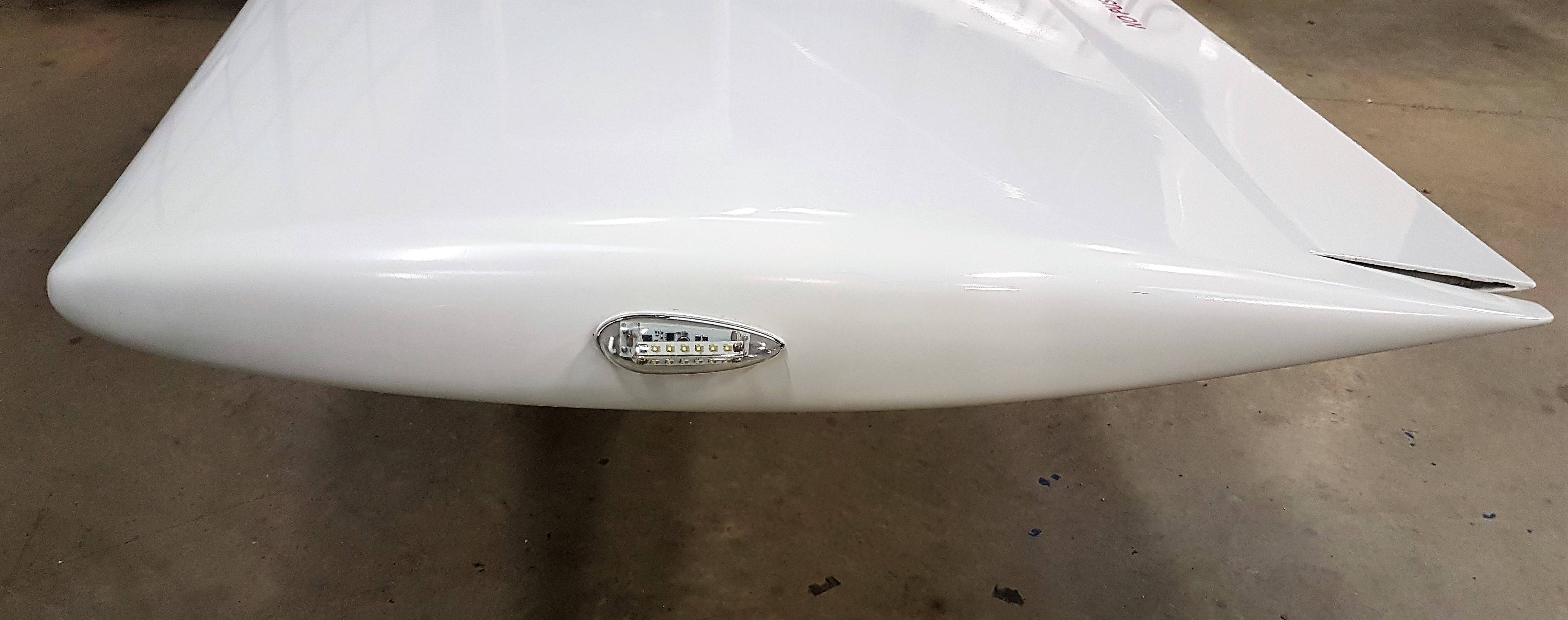

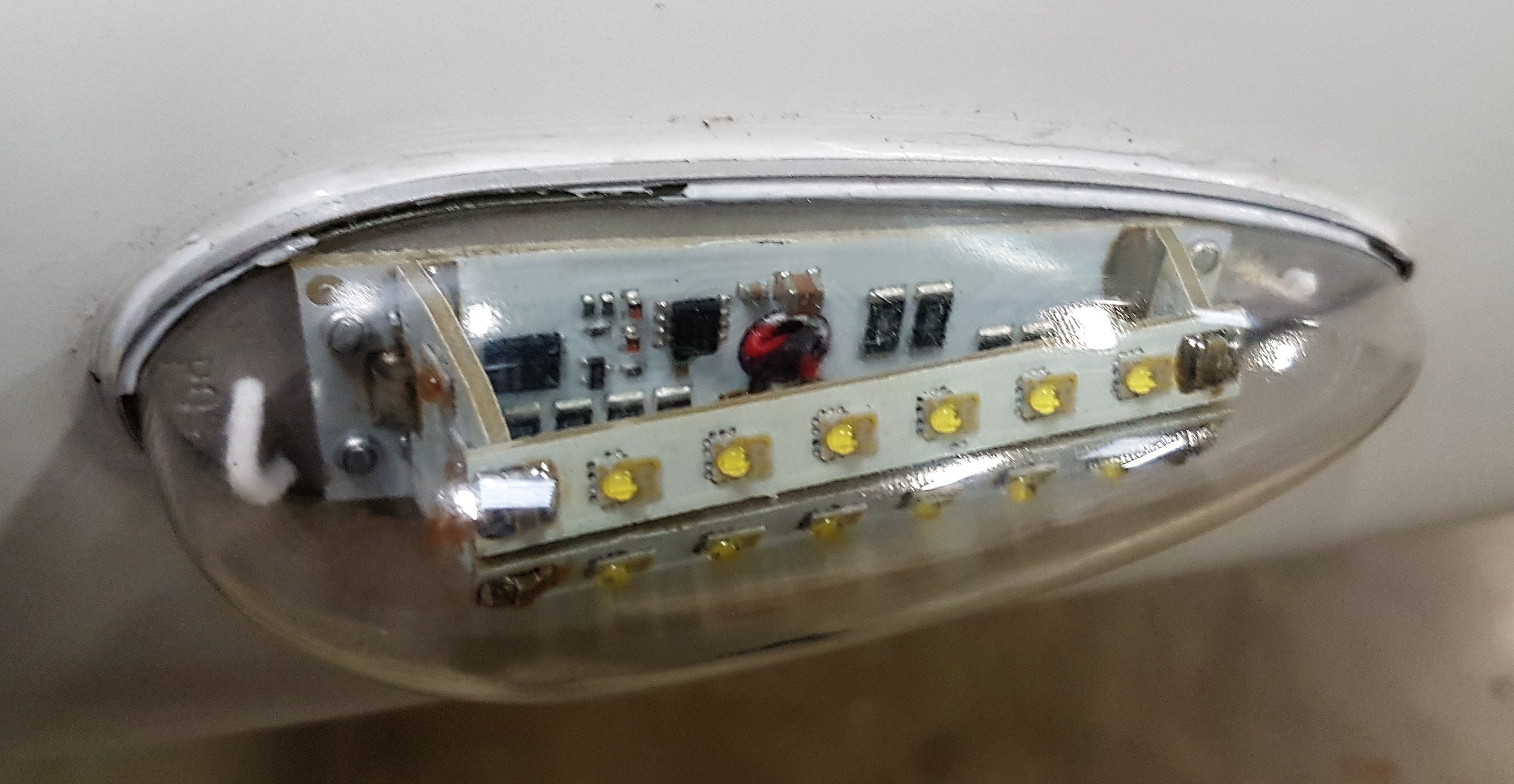

I fitted LED strobes/nav lights from TLAC in to my classic wing. I ran the cable from the wing tip in to one of the channels that runs through the foam to the aileron bell-crank housing, then down the torque tube channel to the wing root.
I've attached the Mod 3 doc, the TLAC details and a couple of pictures. It has all been approved by the LAA. The Mod 3 form contains a detailed descrition of how I fitted them.
Sorry about the size of the pictures. I forgot to reduce them. Sad
