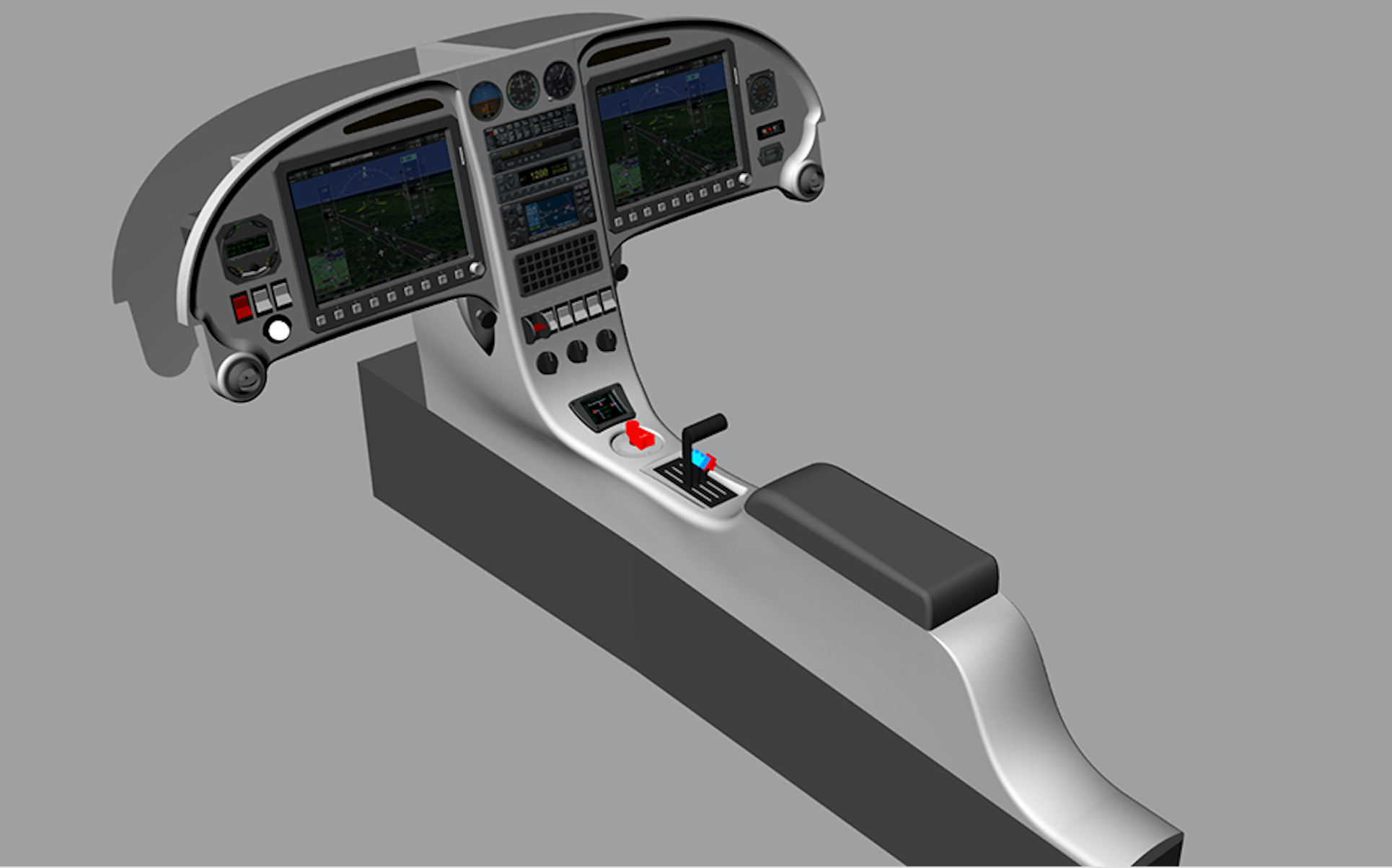

I had a Diamond Katana with center console mounted controls and wanted my -10 to have the throttle quadrant in the same place. Had to make a custom center console to do that. It worked out well. Glad to see that Geoff now offers that configuration. With the throttle quadrant in the center console you can just slide your arm forward on the armrest and you are on the controls. Pretty convenient. For fine control you can anchor your fingers on the right side of the console and move the knobs with your thumb.
The lining in the original (green) cables melts after a while and it becomes hard to fine tune the mixture and even the prop. Ever since I switched to the black cables from Push-pull.com all the controls have been smooth and adjusting the mixture accurately is never an issue.
Here’s a picture of an early 3D rendering of my panel/console.
[img]cid:76A7077C-5505-4D5C-A5E8-362AB9D0490E[/img]
Lenny
