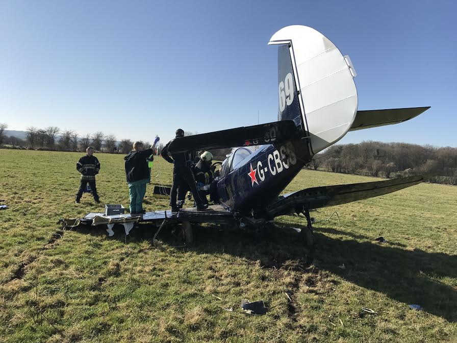

Also had a Yak-52 (G-CBSS) engine failure that led to a forced landing on Tuesday 14 February 2017, 11:45 LT - Belgium.
http://siena.rosselcdn.net/sites/default/files/dpistyles_v2/ena_16_9_extra_big/2017/02/14/node_45023/117972/public/2017/02/14/B9711130446Z.1_20170214202028_000%2BG548HAFT3.2-0.jpg?itok=qKon6c7X
Engine (M-14P) had recently been overhauled by Aerometal (Hungary)...
http://siena.rosselcdn.net/sites/default/files/dpistyles_v2/ena_16_9_extra_big/2017/02/14/node_45023/117973/public/2017/02/14/B9711130446Z.1_20170214201956_000%2BGNN8HB8DG.1-0.jpg?itok=CXmXyV-2
Engine will NOT be examined by Air Accident Investigation Unit -AAIU (Belgium)...
So ... cause(s) of the engine failure will not be determined either ... Sad

PostPosted: Sat Nov 11, 2017 2:28 am    Post subject: Accident Report Yak-52 forced landing due engine failure. Reply with quote
Etienne – I know that it is your habit to publicise everything that you do
in aviation to the widest possible audience. But it is completely
unacceptable to say after an accident report "engine had recently been
overhauled by Aerometal (Hungary)", as if to suggest that the engine failure
was something to do with this overhaul one year before. As I wrote to you in
July this year, it was very clear that the engine and the fuel fittings had
had a number of completely unauthorised modifications after delivery to you
and operating the aircraft. These modifications were all in the fuel system,
and it is a reasonable conclusion that the engine failure was caused by a
fuel problem, and indeed that this fuel problem was almost certainly caused
by the changes to the engine subsequent to its installation. There was
absolutely nothing to suggest a basic problem with the original overhaul,
and I hope you will publish a retraction to accept this.
Richard

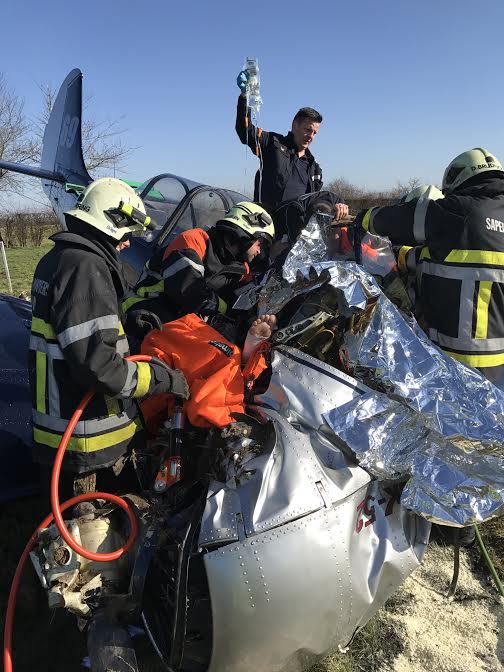

PostPosted: Sat Nov 11, 2017 12:03 pm    Post subject: Re: Accident Report Yak-52 forced landing due engine failure Reply with quote
Dude,
The pictures of your Yak 50 are very cool.

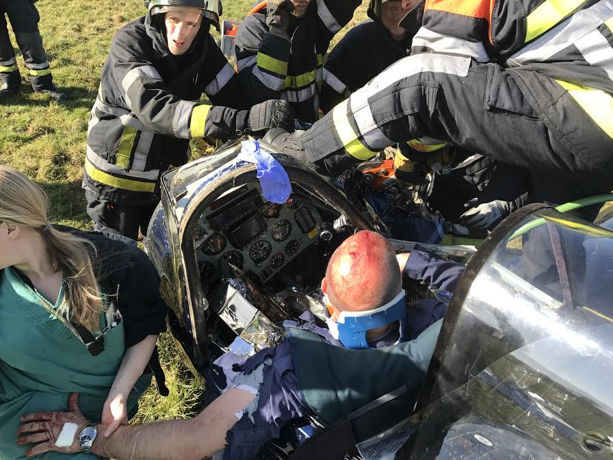

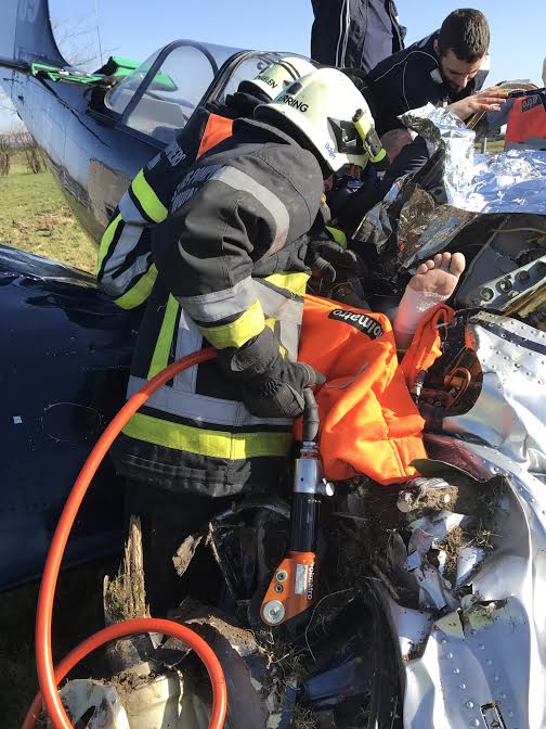

The pictures of the guy getting removed from the Yak-52 are so far from being cool it is not funny. I doubt anyone here ever wants to see a fellow aviator in that condition.
Post as many pictures of flying planes as you like, but please don't post any more of crashed ones, especially ones with injured (or worse) people in them.
Chris
