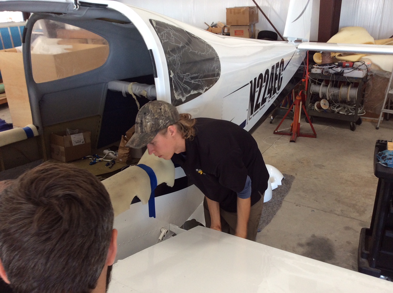

It’s not tippy side to side at all. You need to prop the tail up until you get the engine on. You would need several hundred pounds on the nose to hold the tail up in a stable way. I would just put a stand on the tail like in he attached picture.
