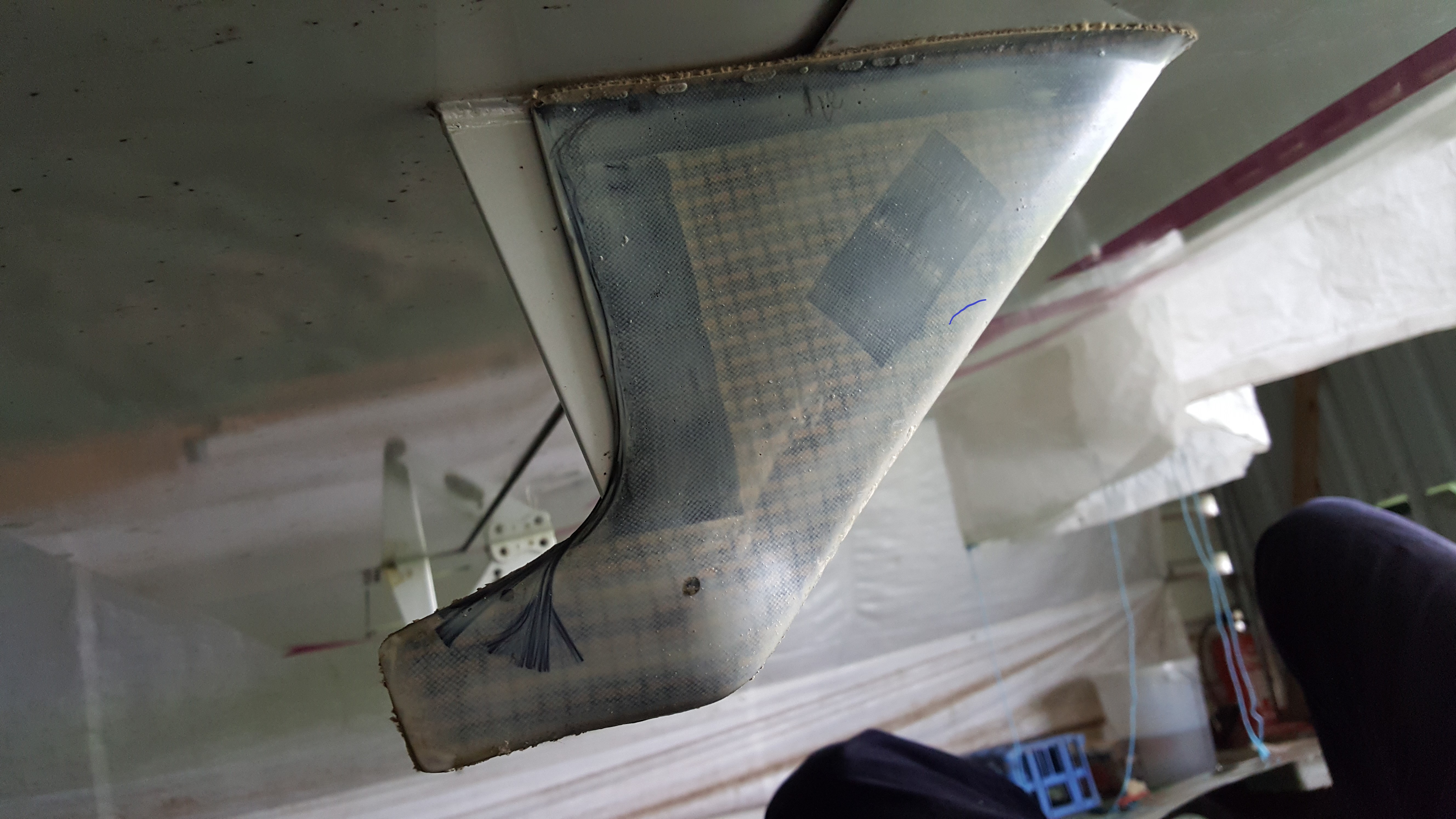

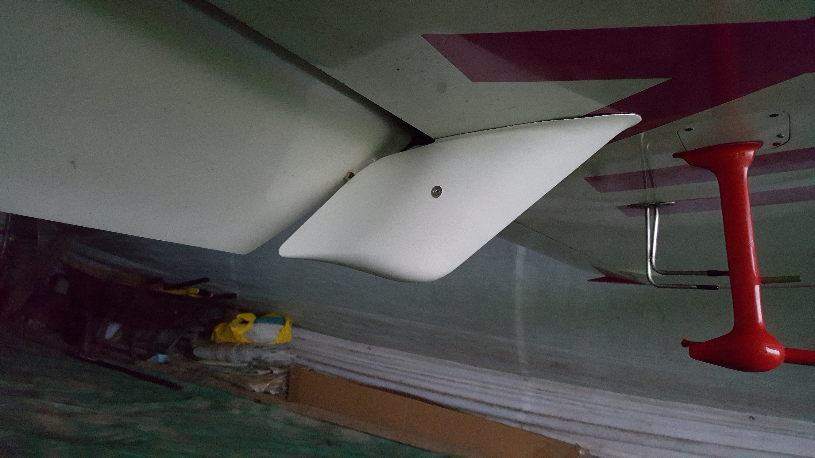

PostPosted: Sun Oct 29, 2017 3:23 am    Post subject: Full trigear speed kit vs hinge fairings only Reply with quote
[quote][quote]Maybe the attached would qualify as a fence.
I made these years ago but never got around to fitting or flying them, not believing that three 1/8" flap hinge plates edge-on to the wind would create more drag than the greatly additional skin and frontal areas of the fairing (although it has better form, with prospect of pressure recovery).
Maybe one day!
Duncan McF.

PostPosted: Tue Nov 07, 2017 3:08 am    Post subject: Full trigear speed kit vs hinge fairings only Reply with quote
Yes that is sort of what I was thinking, but a bit longer towards the L/E to really blend it nicely.  As for the frontal area, or Flat plate area, I think I read (tried to find it again but cant)
That the FPA for drag is any surface between zero and approximately 45 degrees to the air flow, so any surface blended at an angle greater than 45 will have little to no induced form drag.
And the amount of skin drag as compared to the whole skin of the A/C would be so small as to not be of any real concern I would think, again I could be wrong. Obviously the inner hinge fairing could be very thin possibly even just a blending at the front and a fill insert between the two parts to close the gap when the flaps are up.
If anyone knows the actual figures for the FPA I would like to know

[quote][quote]<<...Obviously the inner hinge fairing could be very thin possibly even just a blending at the front and a fill insert between the two parts to close the gap when the flaps are up...>>
Something like the attached? Which also covers the attach bracket/bolts and the pivot bolt.
Duncan McF.

[quote][quote]
Maybe one day!
Duncan McF.
