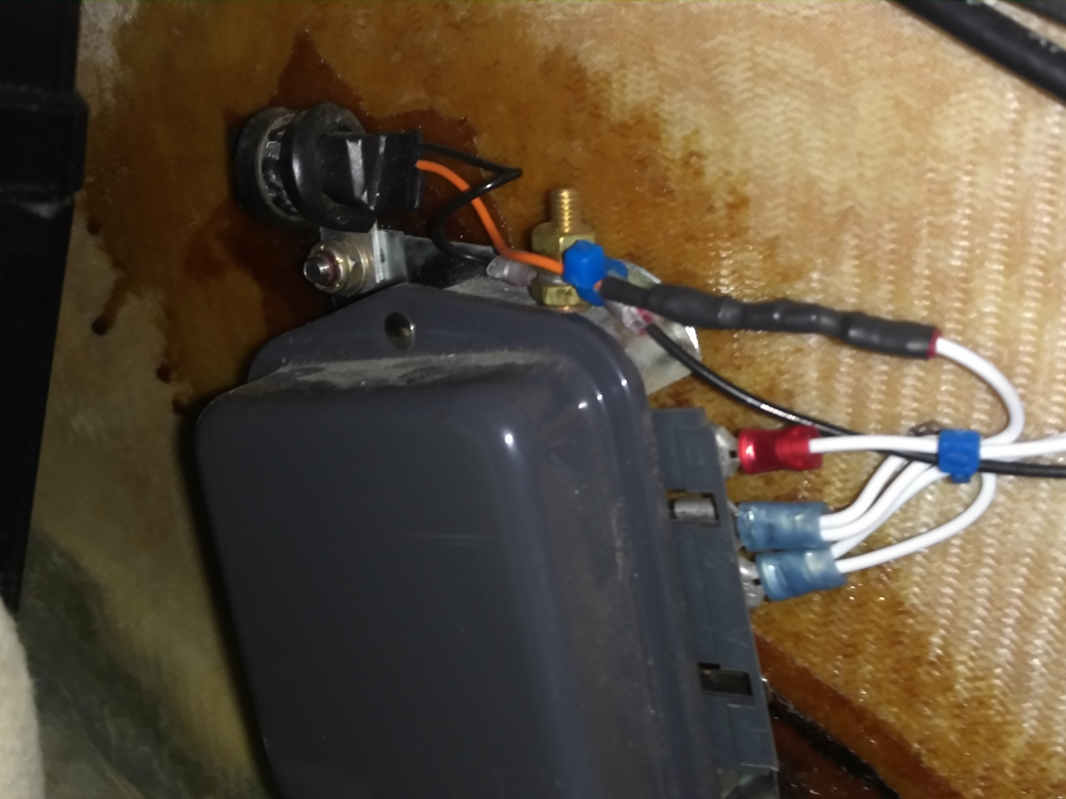

Here's an odd one...  My O235 powered Longeze use a vintage externally regulated 40A Toyota alternator paired with a no-name after-market "Ford-style" regulator. (see attached pic):
I've got it wired in the (Aeroelectric) traditional way with an overvoltage crowbar (visible in the picture) and a 5A breaker on the field winding.  Undervoltage is redundantly apparent via a traditional Westach voltmeter and A Perihilion low-voltage indicator.  All the wiring (which I have yet to re-inspect) has lots of strain-relief, all PIDG connectors etc.
Nonetheless, today I observed that when I pull high positive G's, the alternator drops out (low-voltage light illuminates, voltmeter shows ~12.5 volts or so) but no excess current was observed on load meter (I didn't *specifically* check  it so I might have missed the details here... But it is located adjacent to the voltmeter so I *might* have noticed something odd if present, or I might not have - remember, I was in the middle of pulling Gs...).  I've been flying it, as wired for years but haven't done much pulling Gs before so I don't know if this behavior is new or not...
Of course I'll be double checking connections etc. but I'm wondering if it's possible that the ford-style regulator I installed could be G sensitive?  I can't image it but thought I would ask...

No, but alternator brushes are. They are held
against a slip ring with springs that don't
want to be too aggressive . . . they're relatively
soft carbon on soft copper.
If you could monitor output voltage from the
regulator's field terminal while duplicating
the event, I suspect you'll see regulator
voltage go UP while alternator output is going
down. I.e. the regulator may be screaming
at an alternator that isn't listening.
