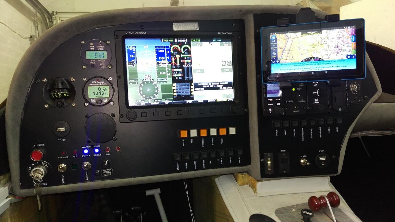

Hi William,
When I bought a replacement panel from Europa, I found that it did not fit, as the original builder had used a modified module. Karen was good enough to take it back.
I decided to design my own, using s a free 2D autocad system (Draftsight). This had several advantages. I could play with various layouts to find the best for my needs. I could also have it laser cut using the output to get clean holes for the instruments and switches. I had the design cut in MDF initially, so I could check that everything fitted correctly, before having the final panel cut from aluminum. This resulted in some minor changes, before the final cut.
Several other forum members were kind enough to send me their CAD layouts, which I altered to suit my needs, and I would be happy to do the same now. This saved a lot of time , as the measurements for instruments, switches etc. didn't need to be re-entered, I could do a lot of cut & paste.

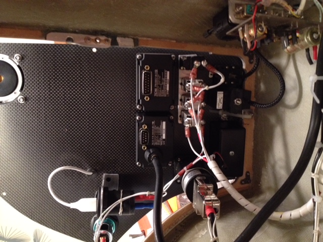

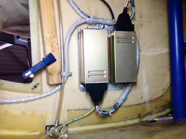

I recently installed a Trig radio and transponder on the right hand side of my instrument panel.
I did buy the aluminium panel from Europa but in the end I made the panel out of 2 mm thick carbon fibre, the cut-outs were done using water jet. I think 1.5 mm carbon plate would be sufficient.
I put the control heads in the panel and the rest behind the baggage bay bulkhead in my classic.
It was necessary to rewire the trim to allow the panel to hinge down for access and of course all the other electrical items on the that panel.
Access for maintenance will be much easier in the future.
John

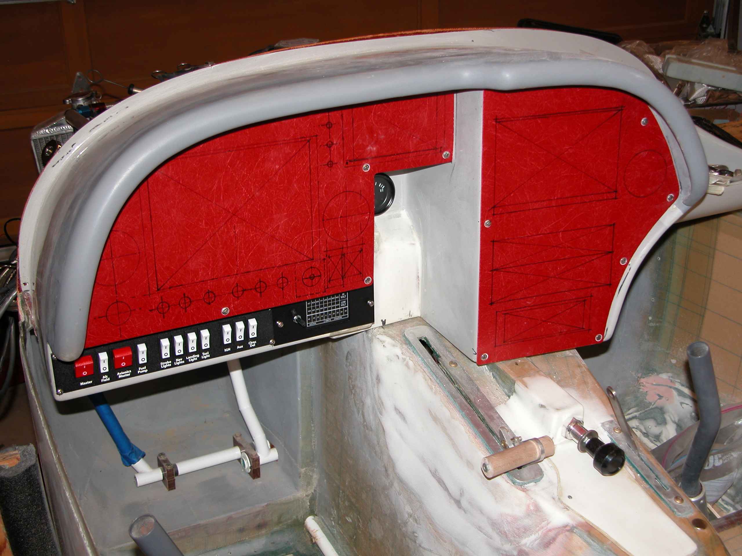

-> Europa-List message posted by: William Bliss <william(at)wbliss.co.uk (william(at)wbliss.co.uk)>Does anyone have any tips, experience etc of retrofitting the mod 63 instrument panel cut out?
Consider FG sheet goods instead of aluminum…very easy and forgiving to work with…save some weight…inexpensive…zoom in to note instrument layout mark up on attached photo:

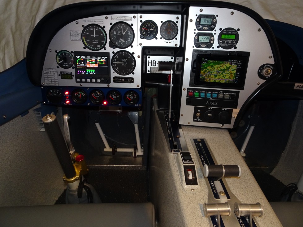

r.vogel(at)ggs.ch
PostPosted: Tue Oct 31, 2017 10:35 am    Post subject: Removable Instrument Panel mod 63 Reply with quote
Hello William
You can see attached CAD drawings used for my Europa Classic.
I think the outer contour should fit to other Europas too.
The drawings are in DXF - format. I am using the low cost, but powerful
CAD tool QCAD. See: https://www.qcad.org/en/
The generated DXF - file could use direct for cad milling or laser cutting.
My panels are 1.5mm thick. I have got a library with lot of instruments
and avionics in DXF. Please let me know if you need something.
Best regards, Ruedi
