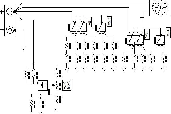

Here's an exemplar switched resistor load bank I built
for a customer
[img]cid:.0[/img]
Resistors are mounted on 1/8 alum plates and force
air cooled. The little collection of parts in the
lower left corner are a zero-to-max variable load
used in combination with switches to 'dial in' what
ever load you wish to run at.
