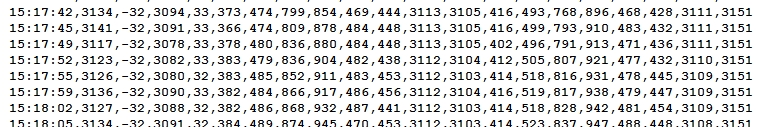

Here's a typical data file from a task I did at Beech.
First column is time of day to the second . . . followed
by 20 columns of values between 0 and 4095 (0 = 0V at the
input the the analog to digital converter; 4095 =
4,095 millivolts at the input). The a/d also resolves
polarity of the signal so you see one column with a minus
sign on the numbers.
[img]cid:.0[/img]

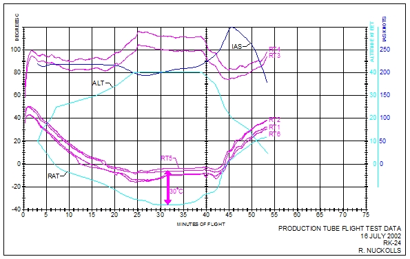

After boring holes in the sky and smoking off a few hundred
gallons of fuel, you go back to the desk and convert all these
numbers into interpretable displays . . . my favorite at the time
was to craft utilities in TurboBasic to put offset and scale
factors on the numbers which were then spit out as script files
that plotted pretty lines onto graphing templates in AudoCAD.
The work product comes out looking like this
[img]cid:.1[/img]

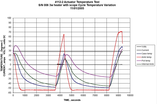

I've also used Excel to good advantage to produce similar
plots.
[img]cid:.2[/img]

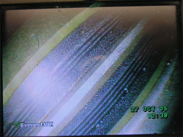

Sometimes, the thing you're looking for cannot be
observed and resolved in terms of numbers. For
example . . .
[img]cid:.3[/img]
Here's a picture of 'tracks in the snow' taken
from the surface of a position feedback potentiometer
in an actuator. The thing would mis-behave on
descent from altitude. Turns out that warm, moist
air pushed into a cold-soaked actuator with increasing
atmospheric pressure would cause condensation and
frost on the surface of the pot . . . disrupting
its functionality.
As the pot wiper stroked the length of the pot,
the fingers would plow little tracks in the frost.
That was a challenging investigation. The video camera
wouldn't work at those low temperatures . . . had to
strap a power resistor to the side of the camera
housing along with a temperature sensor and controller
to maintain the camera at about 10C.
