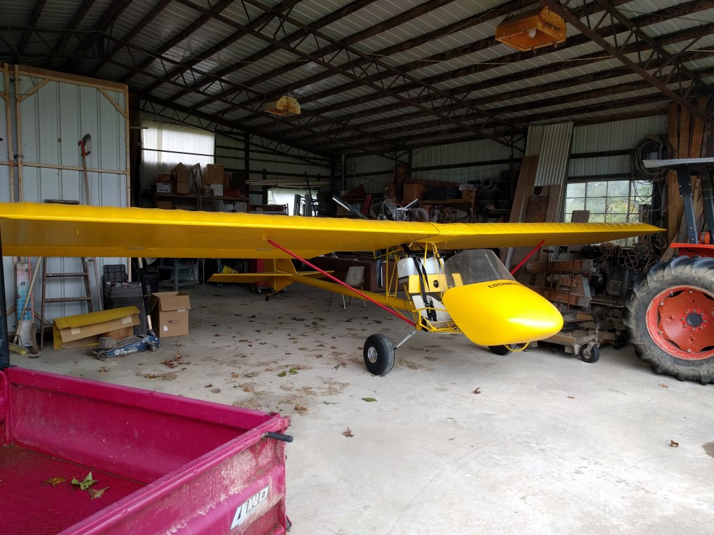

Getting ready to weigh the Twinstar. Anyone have a clue what part of the airframe can be leveled, to put it in flight attitude? On this one, leveling the top tube gives about 5 degrees positive AOA on the bottom of the airfoil. Does this sound about right for doing W&B? Was there ever a preferred datum point on these old planes?

Charlie, I’m pretty sure the wings leading edge is the preferred datum. On a level surface the bottom of the wing should be set 8 or 9 degrees by raising or lowering the tail. It’s looking pretty nice in your picture.

Thanks, George; I appreciate it.
My a&p buddy was guessing at 2-3 degrees of actual angle of attack, so I'll need to adjust a bit.

Charlie, Set the horizontal stabilizer level. As for datum, it doesn't matter as long as you're consistent with your measuring and you don't get minus and plus measurements if your datum is somewhere in the middle of the plane. I use a point 20 inches in front of the nose, that way all numbers are positive. You could just as easily make it 20 inches aft of the tail. It doesn't matter.
