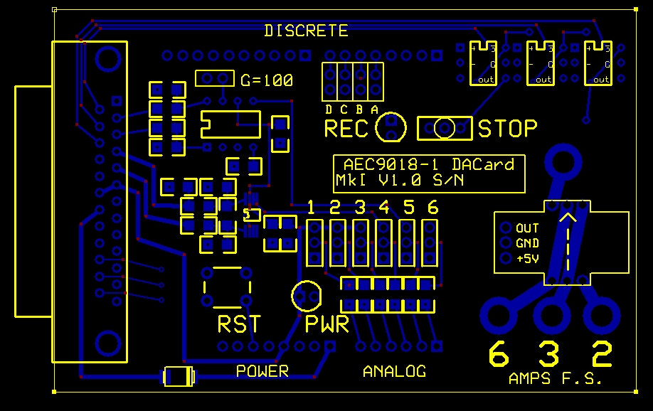

Oops. I intended to send this to Paul . . . but no harm
done. Among other things, Paul has put some considerable
effort into integrating a OBAM aircraft friendly data
acquisition board . . .
[img]cid:.0[/img]
With the Arduino Uno. This board will feature full, scaleable
access to 6 analog analog inputs, three of which have
jumpered options to (1) measure current in a conductor passed
though a hall effect transducer (2) measure temperature with
a K-type thermocouple, and/or (3) strap to a gain of 100
amplifier for gathering of information from low level signals
like strain gages.

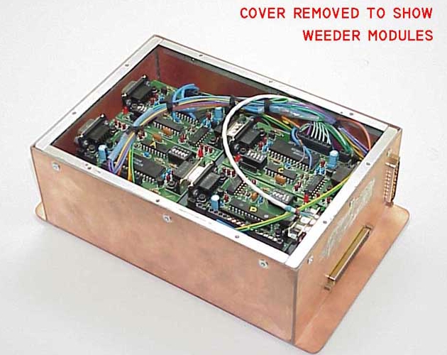

These are the kinds of things I did at Beech for a bunch of years,
but with a fatter budget.
[img]cid:.1[/img]
Now, with Paul's assistance, we'll see if we can bring the cost
down for making measurements of similar quality in a po' pilot's
flying machine. It will fit into a roughly 2 x 3 x 4 inch enclosure and
have enough memory to document your record flight from coast
to coast in an ultra-light.

Paul,
I took a look at the ADC card we proposed way back when.
It still looks good. I'm going to order in some proof
of concept boards and get at least one stuffed . . . then
get it off to you for further sifting of the rats
There are several times I could have used this item over
the past couple years. It would not punch a big hole in
other commitments to get one stuffed and onto your
bench.
