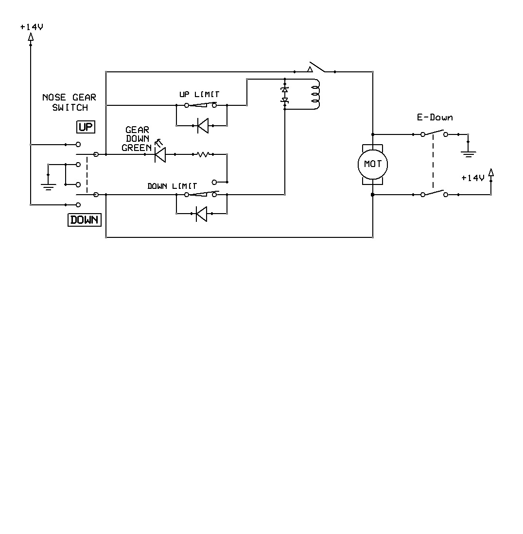

Below is a circuit to lower or raise a landing gear or to control the direction of any small PM DC motor.
The toggle switch controls the motor direction of rotation.
The relay turns the motor on and off.
The limit switches open the relay circuit at end of travel, thus stopping the motor.
Diodes across limit switches allow the current to reverse direction when a limit switch is open.
On the right side, there is an optional emergency switch to lower the gear.
Back to back zener diodes across the relay coil limit inductive voltage spikes.
Disclaimer: The circuit has not yet been proven to work.
