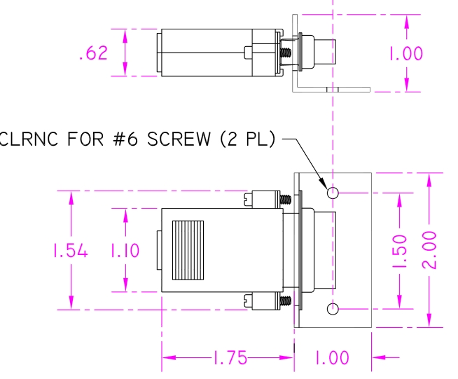

Then there's a matter of packaging. One can easily
spend more time putting a gizmo in a box and installing
it than it took to build the gizmo. Certainly, packaging
issues are a major component of a development project.
A possibility for this project is to package in a
D-sub housing. The enclosure is an off-the-shelf, inexpensive
product that simply snaps onto the final assembly.
An ECB can be soldered directly into the gap between
rows of solder-cups on a dsub.
[img]cid:.0[/img]
and dropped into a plastic housing that simply
snaps together. A product housed in a 15 pin
back shell has these dimensions.
[img]cid:.1[/img]
This project can probably be fitted into a
25 pin back shell. I perceive no particular
advantage in taking power and signals on/off
the board on RCA jacks . . . shielded
wires are just as easily dropped onto d-sub
pins. RCA plugs are not the most installer
friendly connectors.
